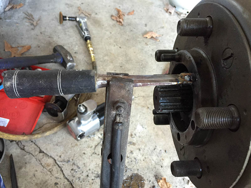

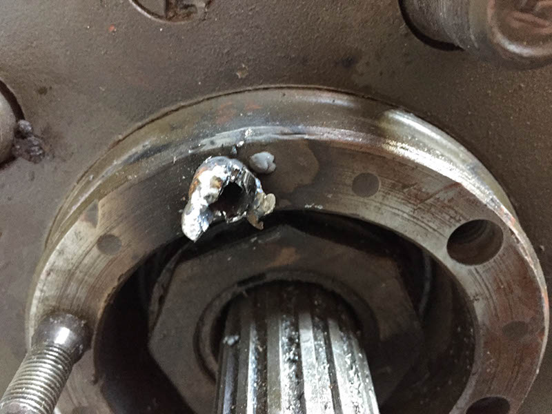

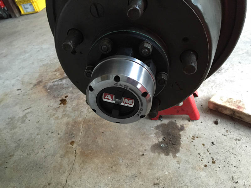

Some minor work done this weekend, nothing crazy. Got the front passenger brake drum on. Should have only taken me 30 minutes, but it ended up taking hours because I broke a stud :evil:
Broken stud
Broken stud
Weld a chisel to it? Nope
I've done it now
I've done it now

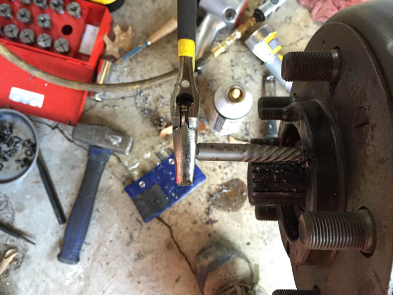

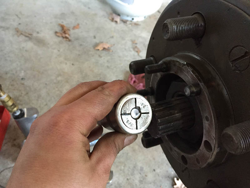

I ended up drilling it out and using a reverse drill bit to extract it. I had to keep stepping up because they just wouldn't grab. Luckily the last one worked! I didn't want to heat it up because she was all painted perty.

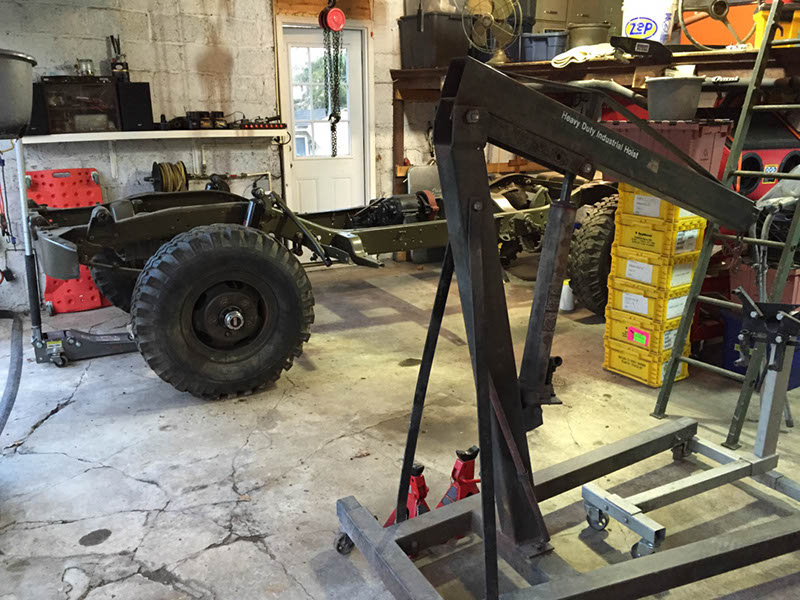

All ready for the engine
Now that the front end is FINALLY together, I can move on to the engine.

@Elwood yup that's the Snap-On stud remover. It was stupid expensive, something like $250 but worth every penny when you are trying to save and reuse parts on these old truck.

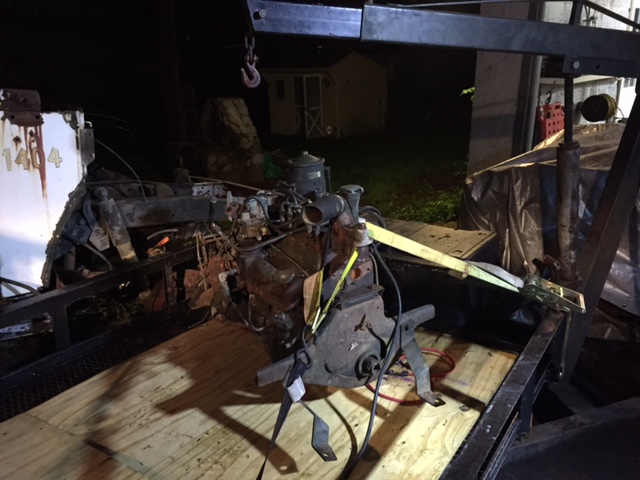

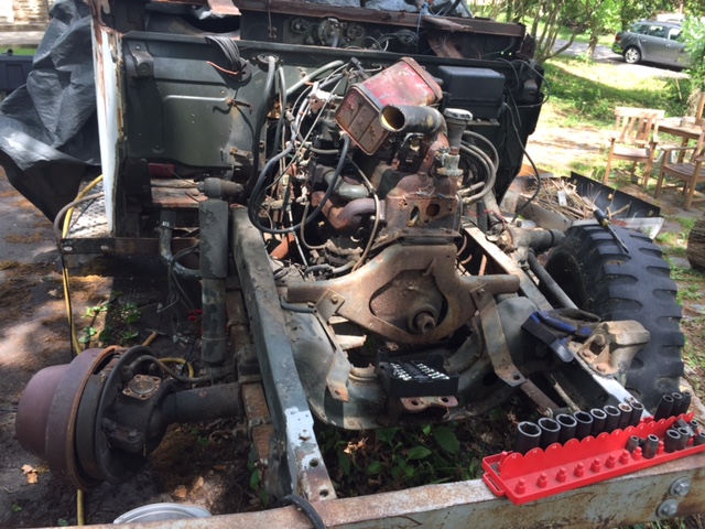

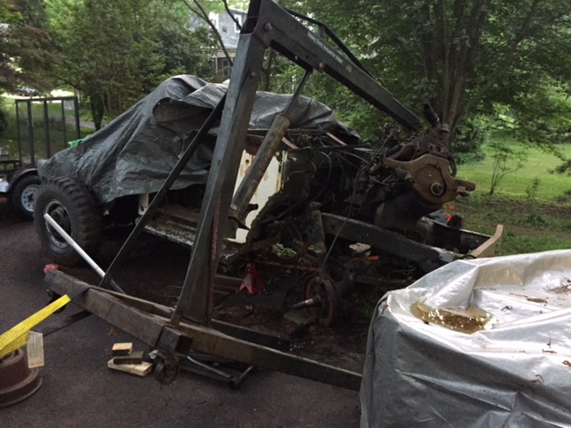

Been a while since my last post so I thought I would share an update. Been busy the past few weeks for sure. Decided to tackle the donor:

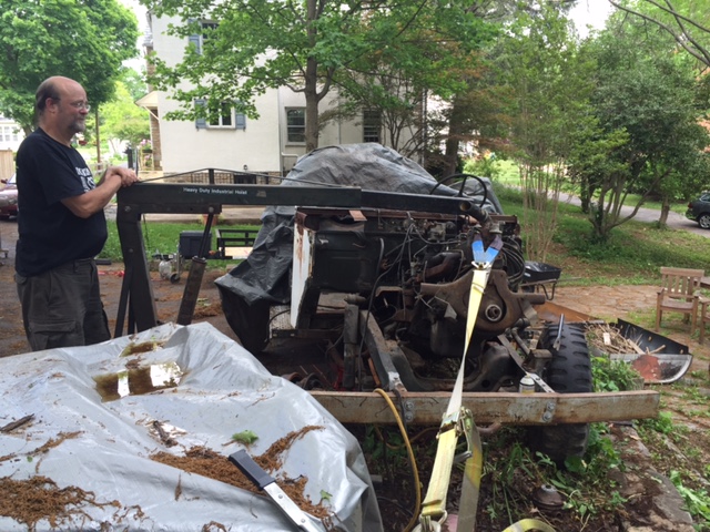

It was in a precarious spot so I had to use a lot of straps and come-alongs to help persuade the cherry picker in the direction I needed. They also acted as kind of a safety because that engine is heavy and there were certainly a few close calls!
Out she comes.

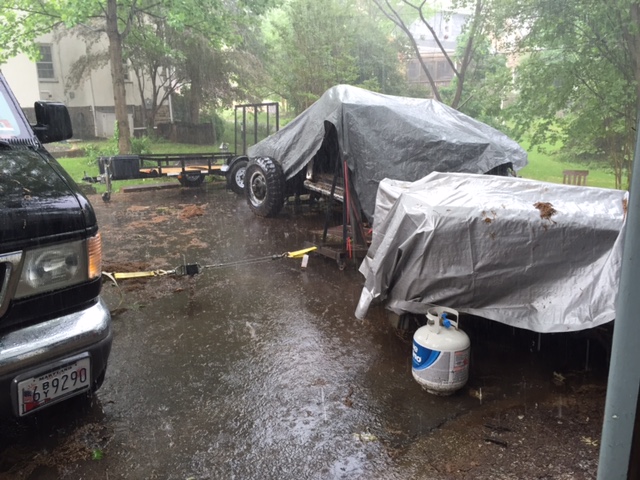

And then came the rain.
Back at it. Notice the angle of the stand :shock: I had it strapped to my van for safety, and I surely needed it!
My prize has been claimed.

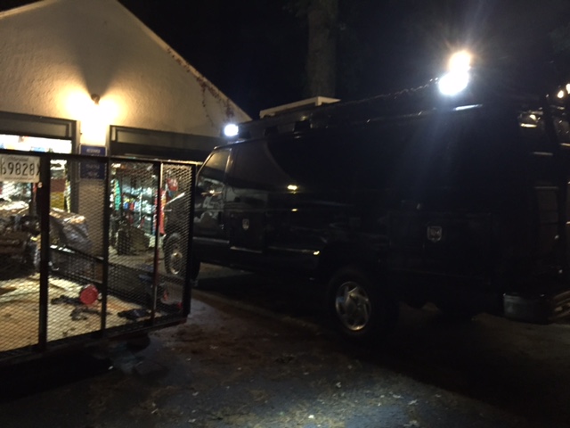

The lights on my van came in handy that night 8)

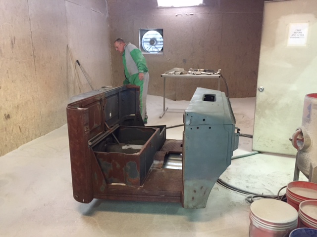

A week went by and ready for more. Before tearing in to the engine I brought the tub out to get blasted:
In the blast room:
I'll post some after pics when I pick it up.

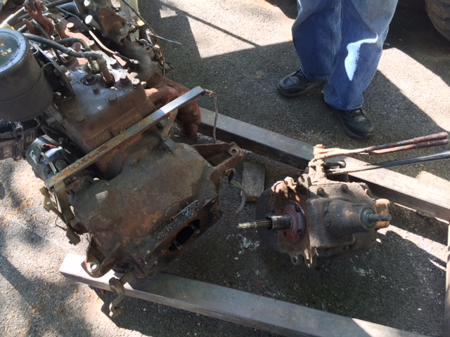

Today I started the engine teardown. First separated the transmission from the bellhousing.

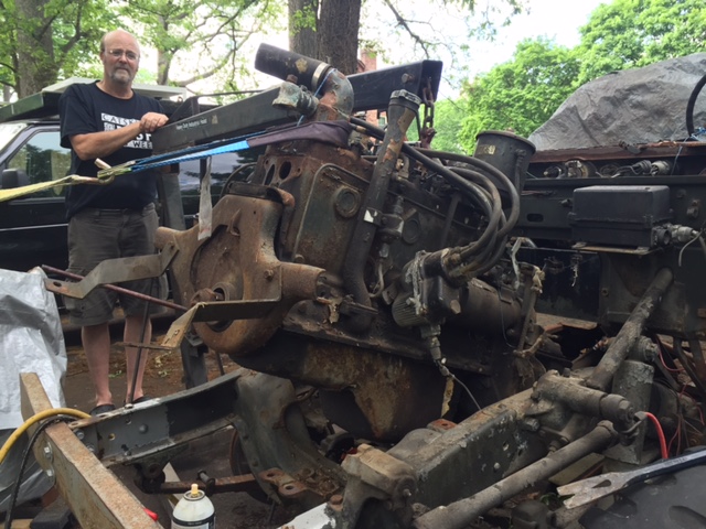

And then all the accessories, down the short block. This is my dad, the original owner of the truck.

I went for the selfie too. Figure I don't appear much in these photos!

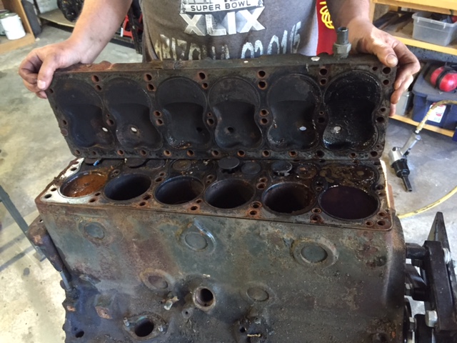

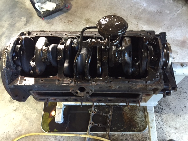

OK enough of that. Got the engine on its stand then pulled the head. It looked pretty rusty and nasty in there :(
There was a bit of water because the engine got rained on while it was out for a few days. I know I should have covered it, but I didn't. Hopefully it doesn't mean anything. I'm planning on rebuilding it anyway,
Pulled the oil pan to see what the bottom looked like. Pretty clean, no obvious damage that I can see yet.
Tomorrow I am going to try to tear in to the crank, pull the timing cover, etc. Break it down to the block so I can bring it to a machine shop. I've got a lot of reading and research to do at this point. This is all uncharted territory for me, not that I have had any idea what I am doing up until this point! All I can do is take some pics and learn from my mistakes. Worst it could do is not run, right? How's that any different than where I am now? hehe.

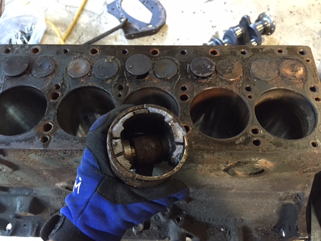

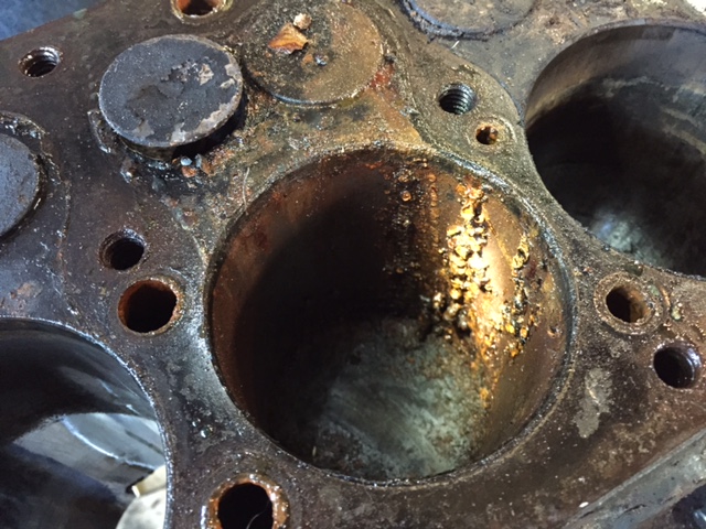

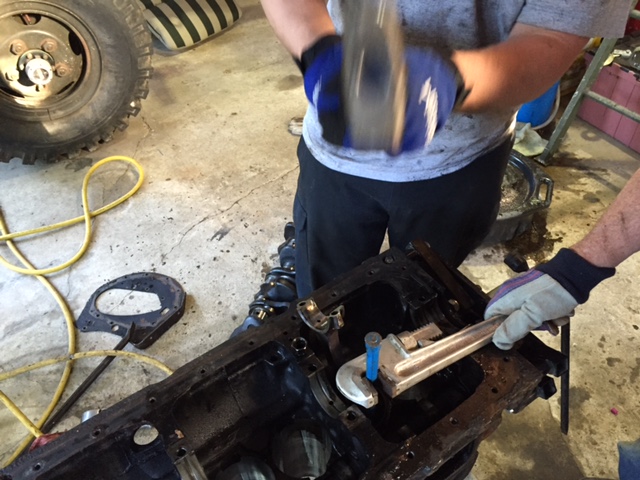

Back at it in the garage today. Found out why I wasn't able to crank it over:
I'm guessing my head gasket must have been bad or something and some water got in there. They were all kind of nasty but this one was particularly bad. All the pistons came out with a little persuasion, but not this one!
So we went with the BFH
Finally she came out, but I don't think I will be reusing these pistons.
At first I was trying to keep stuff as organized and labeled as I could, but at this point I just kind of gave up because it looked like nothing was serviceable.
