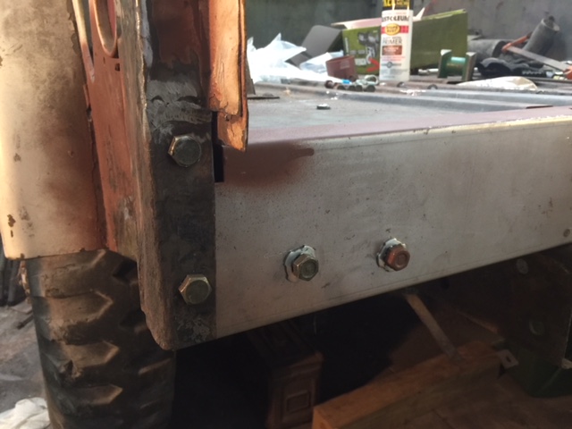

It was a rainy Sunday so I decided to knock out replacing the rear cross member.
Here is the side welded closed that I had to cut open (cheat) to get the cross member off.
John at Midwest Military really did a great job creating this cross member.
The other end.
I have no idea what this extra hole in the floor of the bed is that does not match up with any of the holes in the cross member.
The other end.

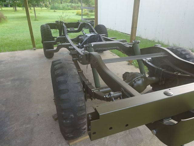

Today I got home early enough I decided to pull the bed off on the M37. Well....... Bubba got me this time.
I rigged up two big straps under the bed and started to hoist the bed. I went slow and the bed just didn't raise up like I thought it should.
Sure enough what I thought was a hard piece of rubber was a piece of metal jammed in between the support and the frame. At least Bubba only welded it to the frame and support on one side where he could reach from the fender well. After grinding for some time in the tight space I was able to free the bed. I ran out of time though and will have to pull the bed another day.
Here it is finally loose.

I should have highlighted the hole I was talking about. It's the hole in the bed floor just to the right of the phillips head bolt. The round hole with nothing in it. You can see the cross member in the hole.
I am guessing one of the previous owners drilled for something.
