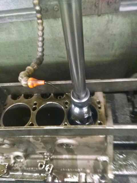

Black mark in the cylinder was left by the boring bar being raised, non issue.
Here is a shot of the final home process of the cylinders to .060". The Sealed Power pistons and wrist pins were weighed. All were the same gram weight.
Next is machining the deck. It had some pitting from cooling water. Machinist feels that .010"-.015" should remove any water damage.

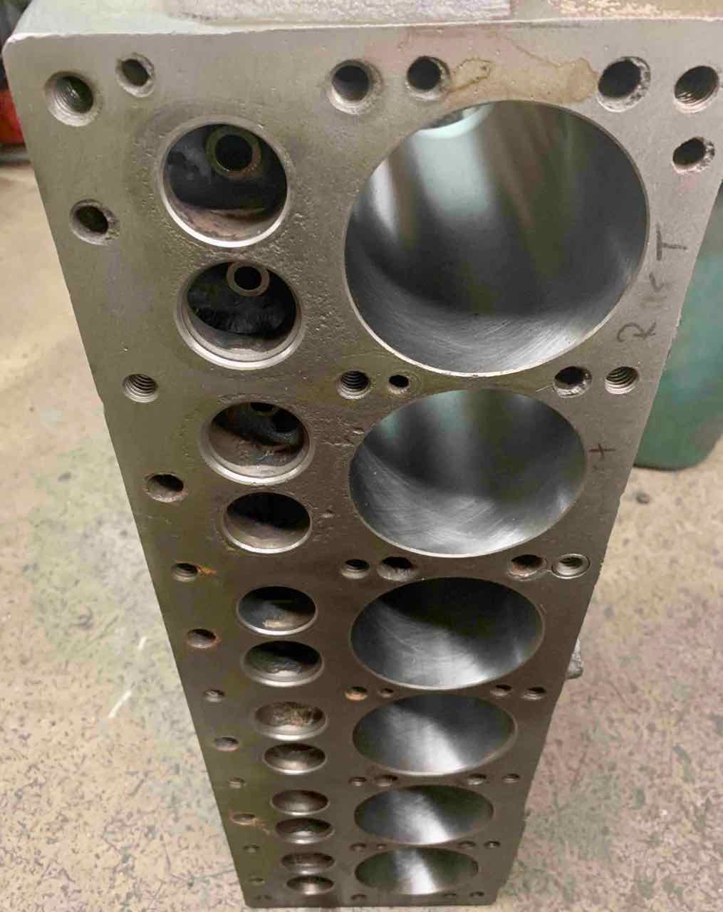

Here is a shot of the block with the valve seats ground. Still have to machine the deck.
block post valve seat grind (1).jpg (69.79 KiB) Viewed 3233 times

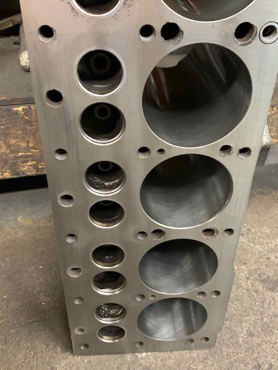

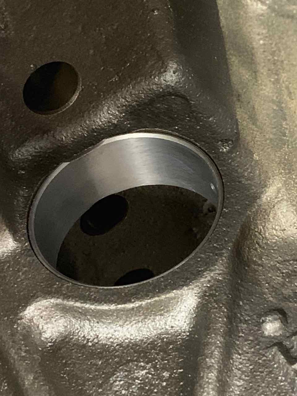

More machine work completed. Here is a shot of the cam bearings installed and the deck was machined. The machinist never saw a engine block deck that was curved from one side to the other. Not front to back. He machined .012" to make the surface flat. There were still a couple of water pits left but NOT under the head gasket area. Tomorrow, I will show up with the camshaft and verify it slides in easily without bearing honing. Engine is coming along. Never fast enough, but forward progress.
230 flat head cam bearing installed (1).jpg (83.99 KiB) Viewed 3183 times

That surface grinder was NOT kind to those coolant passage holes in the block!!! Man that broken out edge is close on a few of them.
On edit, I just went back a few posts and looked at the head before the machining and I can see they were hogged out there also. But now they are REALLY close.
