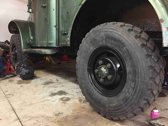

Things have been moving along at the usual snails pace with the truck rebuild. I have now 5 rims that have been blasted, painted and are ready to go. I mounted tires up on 3 of them, and have two to go. When purchasing new tubes and flaps, I was instructed by the local truck shop to reuse the old flaps since they apparently don’t fall apart the way the new ones seem to. Only problem is that I had a lot of large rust chunks adhered to the old flaps which had to be removed. So, three have been cleaned and the final two are sitting in a bucket getting the rust dissolved. Seems to be a pretty slow process, but it allows me to focus on other jobs with the truck.

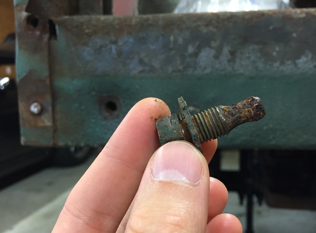

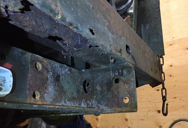

Also, I have started to remove the rear bed crossmember which is badly rusted out. Every single bolt has been a fight to remove, and the four holding the tailgate on were cracked. Two of those broke off and will get removed once the cross member comes out.

The bolts that came out looked like this

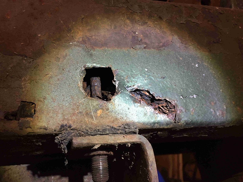

Rust Rust Rust....
Rust Rust Rust....
Bed Bolt.jpg (214.67 KiB) Viewed 28288 times
Rear Crossmember
Rear Crossmember

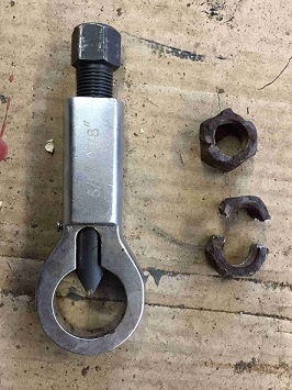

The majority of the nuts holding the bumperettes on looked like this
A very handy tool!
A very handy tool!
Nut splitter.jpg (56.85 KiB) Viewed 28282 times
Michelin 9.00-16 XZL tires mounted up
New Tires.jpg (106.45 KiB) Viewed 28282 times

I think I will have to go the route of buying a new crossmember, but shipping is going to be $$. I was planning on cutting and welding patches in but it really looks too far gone. I'll know for sure once I get it out. It certainly surprised me how deteriorated it actually is. It is probably 3/4 full of rust flakes.
At this point, I am thinking the bed will have to be disassembled and the rust taken care of before I go much further. I was really hoping to get the truck on the road first, but I think I should do it right and deal with the rot.
I do not like rust.
