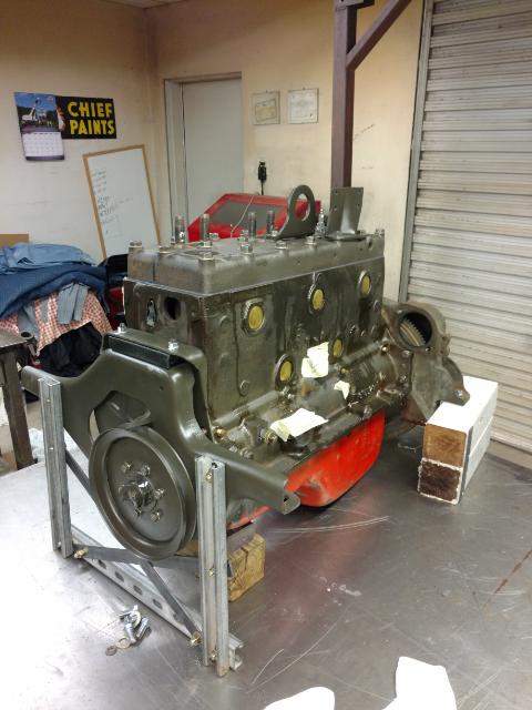

It's a Long Block now

Getting closer
It's beginning to look a lot like engine.
