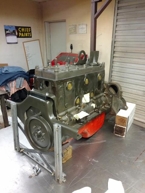

It's a Long Block now

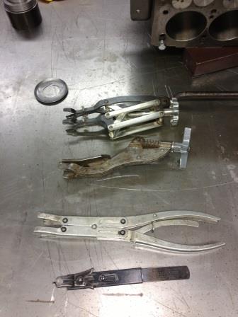

studying your pictures. A question, which front timing cover seal did you choose to use. The Blue one that comes in the Best Gasket kit? Did you put the front plate and cover gaskets on dry, or with some sealant on them? I can only take the heat and humidity in my garage for a couple of hours, even with fans, so I am a day behind you. I found three bolts in my shop return parts that had a small "shoulder" just under the bolt heads, and am using them for the bottom of the front plate. Maybe reduces oil seepage? Loctite anything? I used new main cover lock washers under my main bolts. Did you use new or no special lock washers under your rod bolt heads? I can order them, but it will take several weeks to have them in hand. I think I will use no washer but Blue Loctite on my rod bolts. An oil slinger under the front timing cover seal?
What did you set your ring clearance at? I went with my Grant rings, .011 on all of the cast rings. Any hints for me would be greatly appreciated. By the way, in the back ground of your garage you have some nice equipment.
expansion rings are tricky!
My old removed pistons have four ring grooves, the lower two are both perforated oil control rings. My new pistons have the fourth oil control ring, but the third groove now takes a thin wrinkly expander, which pushes out two very thin rings for more oil control. The Grant instructions are adamant that the ends of the wrinkly expander have to precisely meet, red touching green, to expand the two thin rings. Easy enough.
Except I am Green-Red colorblind, and had to use a magnifier to be sure one did not overlap the other. Which they did very easily when slipping the thin rings on. So used a tiny pick to lift one end over the other. But if I slipped just a little one end or the other would lift out of the groove and then be over a thin ring. Which of course then could not fit back under a thin ring. I worked on one expander set for over an hour, tying to not bend one of the three parts. I finally had to remove expander and both thin rings, not an easy thing to do when the expander is over a thin ring. And start over. I found it very easy for the red/green ends to slip over one another, with the slightest provocation. And it would be easy to see some green and some red, and yet still have one or the other sightly over the other, and not butted. Again, i had to use a big magnifying glass to see that the two half mm ends butted and did not overlap.
I finally found it easier to use a tiny flat tip screwdriver to hold the ends into the groove, while I wound the thin rings into place. The first ring has plenty of room, the second ring has a much tighter fit, and again, it is easy to nudge the butted ends out of place. The instructions are specific as to where the ends of the red/green go, and where the two thin rings are clocked. It is very difficult to spin a thin ring to where it should go after installed, it is a tight fit in the groove. So install the thin rings where the ends are to be, moving them later is hard. And when done, handle the piston/rod gently, so some rap doesn't bump the butts over one another.

NAM VET wrote:studying your pictures. A question, which front timing cover seal did you choose to use. The Blue one that comes in the Best Gasket kit? Did you put the front plate and cover gaskets on dry, or with some sealant on them? I can only take the heat and humidity in my garage for a couple of hours, even with fans, so I am a day behind you. I found three bolts in my shop return parts that had a small "shoulder" just under the bolt heads, and am using them for the bottom of the front plate. Maybe reduces oil seepage? Loctite anything? I used new main cover lock washers under my main bolts. Did you use new or no special lock washers under your rod bolt heads? I can order them, but it will take several weeks to have them in hand. I think I will use no washer but Blue Loctite on my rod bolts. An oil slinger under the front timing cover seal?
The seal that came in the FelPro set. It excludes the use of the slinger, but that is the breaks.
I use an anerobic sealant on all surfaces.
I use Permatex #2 on any bolt not in a blind hole. Especially the ones into the water jacket.
I used Hastings rings. I made a bore gauge honed to size to check rings in. Since they were all within the mfg. spec without filing, I didn't have to fool with any of that. Top, 2nd and 3rd rings are different than the profile of the stock ones. So all specs in the original manual are out the window.

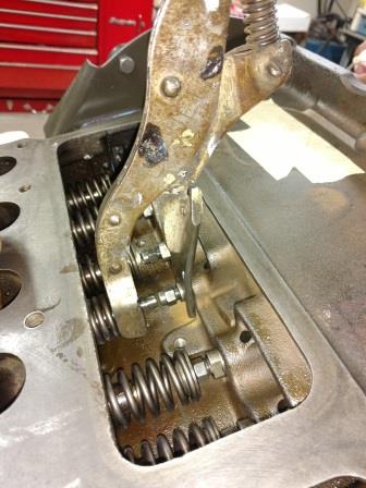

Been doing other things most of the week. But tonight did a full valve adjustment, installed the flywheel and clutch assembly. Installed (temporarily) the bell housing and painted a few more items. Tomorrow morning while it is still cool out, will roll the gantry crane into the shop to stand it up on the table and get the head and manifolds on it.

Getting closer
It's beginning to look a lot like engine.
