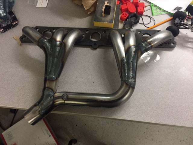

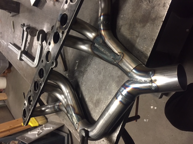

Thanks Andy! As far as i know this is the first time 3d printing has been used in this way for complex metalworking. It's probably been done somewhere..but i haven't seen it.
I'm very curious to see how it performs as well, if anyone has an engine ready to go on a dyno stand i would consider sending it out for testing, just to see how it compares
otherwise my testing will consist of driving it and going 'hmm yeah, that feels pretty good."

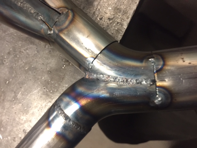

Here's a couple more pics of how the pieces fit together, the same template technique was used on the lower 2-1 collector as was used on each of the 3-1 collectors.
Here you can see the indentations on each side where the 2" collector meets the pair of 1.75" down tubes, these were done with a pair of special vice jaws to make welding a bit easier Pieces are mostly just tacked together here, though some of the "tack" welds are much longer than others. Still learning how to TIG weld. Test fit like this, the front tube comes too close to the fuel pump, but I am planning to remove the fuel pump anyway since the lines are already disconnected and run through an electric pump. The front tube of the rear set of 3 interferes with the PCV breather pipe, so the breather will have to be re-routed as well. Making notes if i build another.

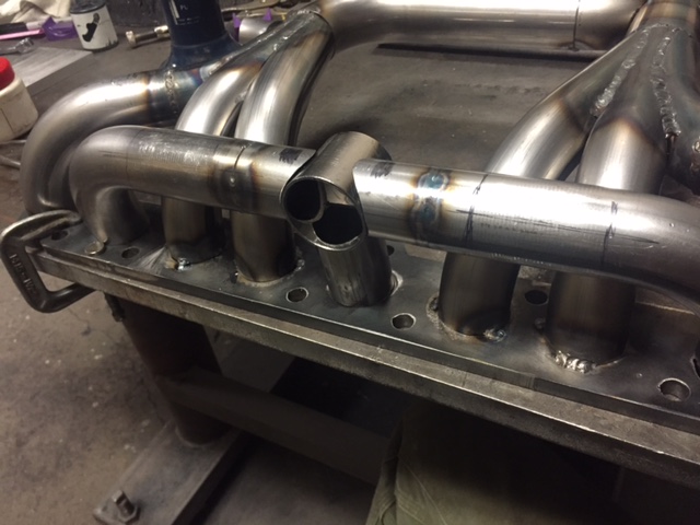

Thanks! It's taken me most of the winter to build, but I've only been finding an hour or two at a time, a few times a week to work on it. Been trying to take enough pictures to document what I did and how I did it in case anyone else was interested in making one.

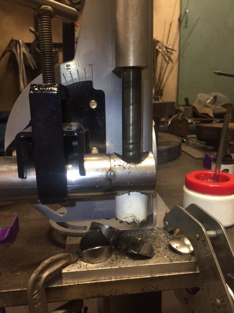

Used a tubing notcher tool for most of the cuts on the intake manifold, these things are extremely handy for making pieces of tube fit each other!
Cutting the intake runners to mate up to the intake collector/down tube. Again no filing or grinding to make these fit, just one cut and you get a near perfect match between the two parts. Cutting the carburetor down-tube. I got a little ahead of myself and cut the piece of tubing to length before i cut the holes for the runners, so i had to tack it back onto a longer piece of pipe to hold it in the notching tool. All fit together and ready to be welded in, the intake is at a slight upward angle to clear the exhaust tubes, and even then i had to make some small indentations along the back side of the intake tube to get enough room. I wanted to avoid mounting the carburetor any higher than the stock manifold located it. Mounting it higher might not have been a bad idea in hindsight, it may have helped smooth out the flow by having a longer down-tube. It would have also allowed the air cleaner to clear the lifted body on my truck. Oh well, I'll make that change next time.

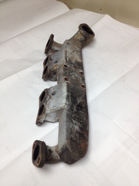

Great job with the header, when I bought my M37 the manifold had a couple of good sized cracks. At the time I hadn't realized there were so many NOS manifolds out there so I also set out to build one. Mine is not nearly as exotic as yours, I made a close copy of the original. If I knew how to post pictures on this site, I would. I can email you the pics if you send me an address.
Thanks for posting all the nice work,
Kelley

I could have had a nos for just a bit more money (I only have a little over $120 in material in mine so far) but I jumped at the chance to learn how to build a header. Grad student, no money, and glad to work on something besides school
I tried to keep the important bits (carb location, throttle cable clamp, air cleaner elbow bracket mount) in the original spots, and took some liberty with the tube locations, outlet location, and PCV port.

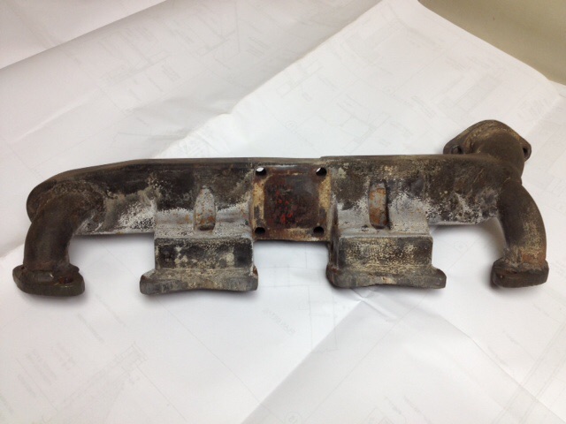

Hearing how expensive and hard manifolds are to get, I decided to pick one up if I could find one. At the last MV show, there was a nice complete one (Intake, exhaust, PCV, brackets, Upper exhaust, etc.) I scored for $20. Problem, for me, solved. (And he also had a very nice, only needs seals-I inspected, LU-4 winch for $200. Now replacing my very worn old one.)
If I hadn't found a good one cheap, I would have definitely built my own. And an intake for two ones or a single 2bbl.

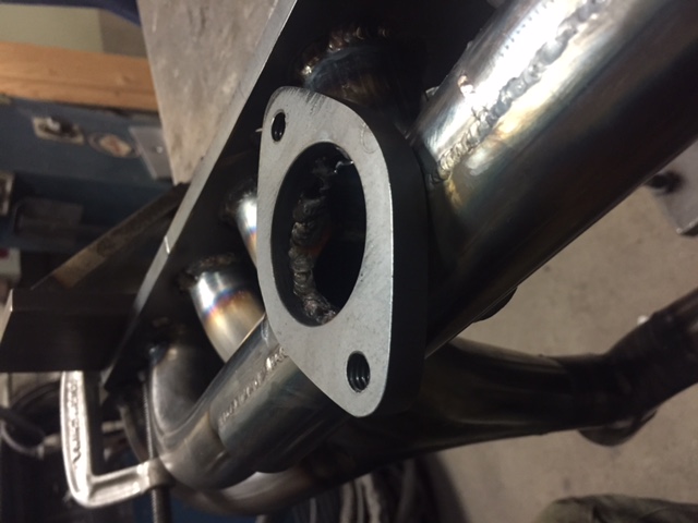

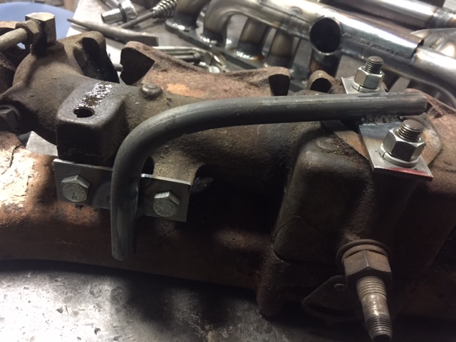

Some more photos, i used a piece of 3/8" plate to cut the carb flange from. used a mill to precicely locate and drill the main hole, and then drill and tap the two stud locations. The oval shape was cut on a bandsaw and then finished on a belt grinder, it's pretty easy to make it as accurate as you feel like marking, and the grinder lets you finish it to nice straight edges.
With the carb flange in place, i wanted to locate the air cleaner elbow mounting holes and throttle cable clamp mount, as near to the original locations as possible. For this, i cut one plate with two holes to bolt across the carb opening on the old manifold, and cut another plate to bolt across two of the cable clamp mount screws. Then, i bent a piece of heavy rod and welded it in place on both plates, so they were located in relation to each other.
Finally, machined some threaded holes from a couple of pieces of bar stock, and then transferred the new pre-threaded mounts over to the new manifold, using the jig i created in the previous photo. All that's left to place the threaded holes is get a few tabs of scrap steel and weld between the manifold and solidly held threaded holes.
