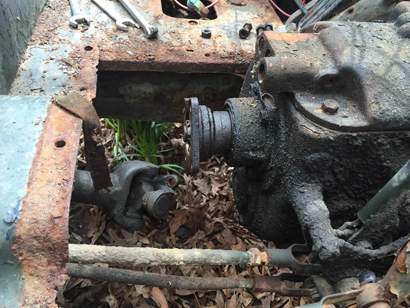

OK got out there today and made an attempt at progress. I decided first thing's first, disconnect the transmission so I can eliminate that from the equation:
Disconnected yoke
Disconnected yoke

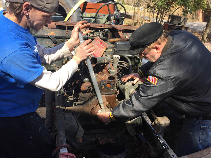

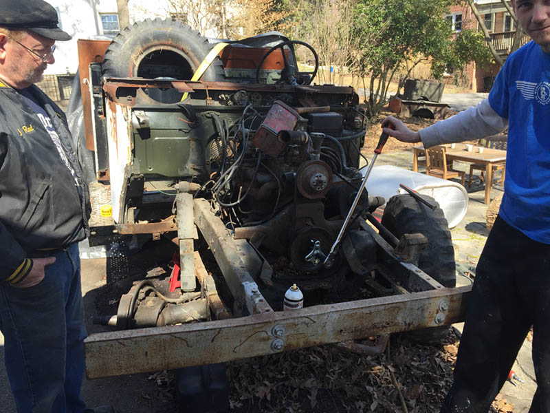

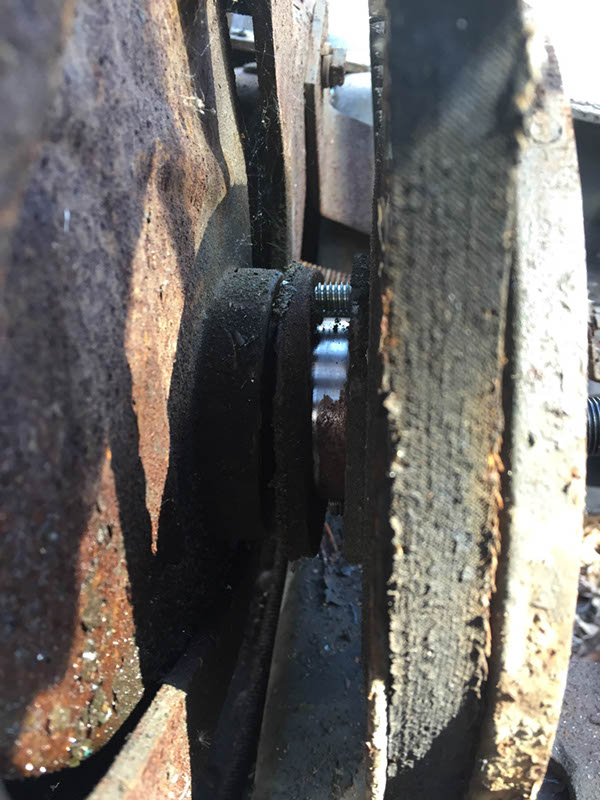

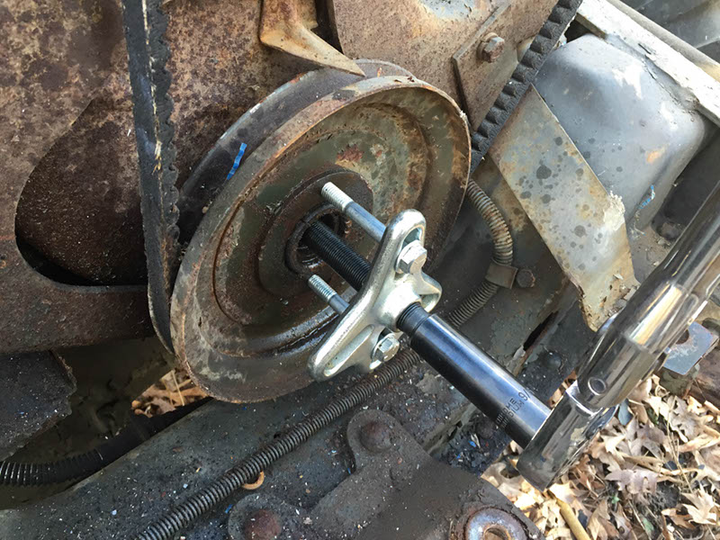

I tried to turn it over and still the same thing. Even tried turning the yoke from the rear but it didn't work. I think the clutch was slipping. I wanted to see if I could turn the engine from the front manually. I didn't have the 1 11"16" socket that fit on there so I improvised and used a pipe wrench and a breaker bar to turn it clockwise. It just kept tightening the nut but didn't turn the crank. It got to the point I was pushing so hard on it I was afraid of damaging the threads so backed off it it. We puled the nut off and then pulled off the pulley all together:
Pulley puller
Pulley puller
Pulley puller
Pulley puller

Here's the pulley sliding off:
Pulley coming off
Pulley coming off

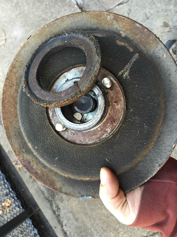

And a shot of it in my hand. Note the felt seal:
Pulley removed
Pulley removed
We put the nut on for one more go at the hand crank, no dice:

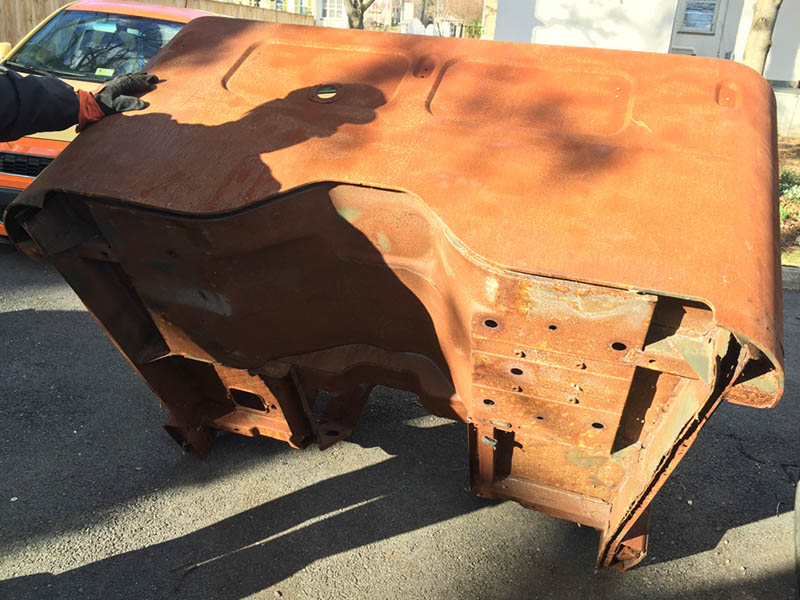

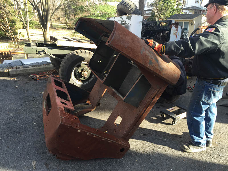

So with the engine pretty much stuck we moved on to taking inventory of some other things. My friend Joe, the skinny young guy owns a body shop and is going to help me figure this all out. I've accumulated almost three set of every body part over the years so we picked out the best one for the restore. Here's my tub:
Tub for restore
Tub for restore
Tub for restore
Tub for restore

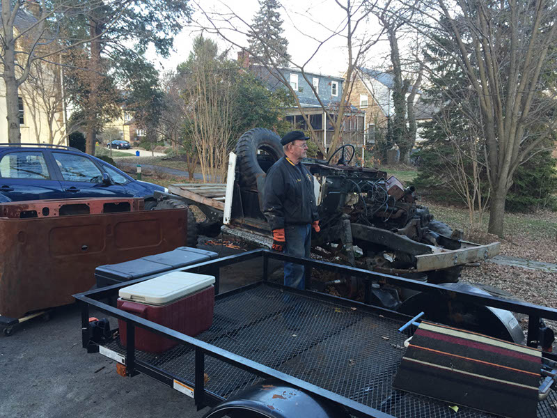

So with that we pretty much got everything buttoned up and called it a day:
Now what?
Now what?
So I need some advice here. I've now got two seized engines. The one on the donor truck (pictured) ran. I drove it on to the trailer, but sitting for so long has caused it to seize. I've tried all the conventional methods of freeing it like marvel mystery oil, seafoam, etc. The other block is really in bad shape. My buddy thinks that with the right parts and a trip to the machine shop we can get her going again. I like his optimism! There's someone on the board I contacted here local to me who is looking at doing a V8 swap and wants to unload his running 230 for $500. It still needs to be pulled. Does anyone have realistic rebuild costs from projects they have worked on? I'm sure I can get the parts from Vintage, probably even get some at NAPA. Is it worth the rebuild or go with the runner? Thoughts?

Thanks for posting the pics of the pulley removal. It looks like the pulley and hub are permanently assembled, not bolted together like the stock M37 arrangement?
jrodjared
Posts: 78
Location: Baltimore, MD
Re: 1962 M37 Newbie Restore
Post by jrodjared »
@Elwood yeah if you look at previous pictures in this thread you will see that this engine has a weird pulley arrangement that's permanently affixed. My other block has the more common six bolt setup. Someone on here was saying that there were different variances based on applications, some with six and some with four, etc. Never saw one like that before though.
