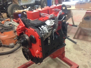

3600rpm (ish) in 4th with a 35" tire should net about 60mph with the stock gears on a 4bt.
2880rpm (ish) in 5th at same speed with same tires and gears, sporting a 20% overdrive.
Still seems like too much rpm for the diesel to me, but I'm not a diesel guy, I'm a trashy gas lover... :P
I can hit close to 60mph in 2nd gear if I wind out the 428, with 4.56's. At least I know when the SHTF I can out run it.... :mrgreen:
But I'll give you props on making the wood chipper engine look pretty! :lol: I'd be stoked to open the hood and see that under there...
