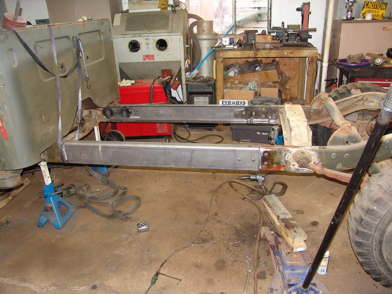

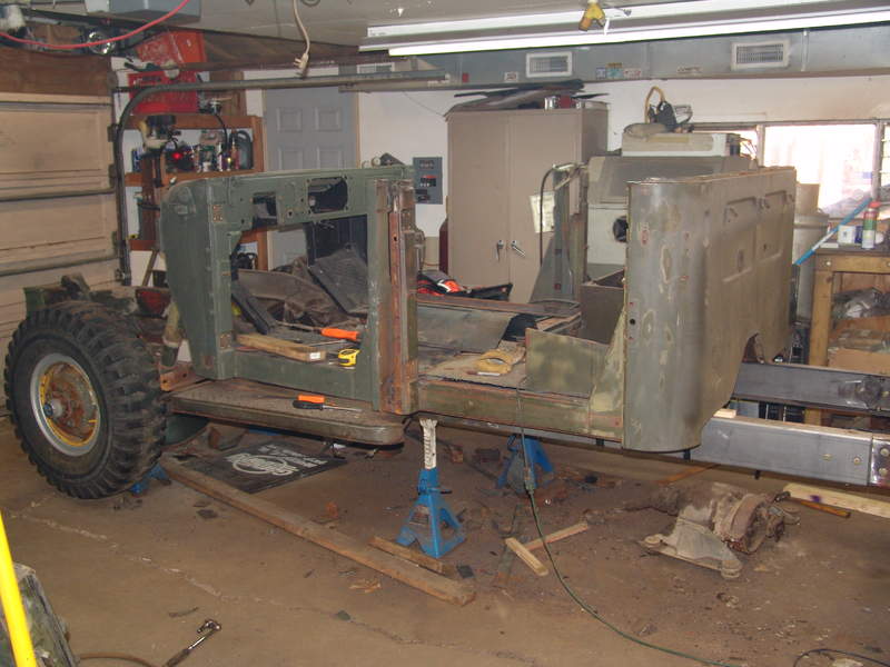

Crew cab is possible if you have time and the will to build it.
m37 10.jpg (85.6 KiB) Viewed 2598 times
m37 22.jpg (71.8 KiB) Viewed 2598 times
m37 32.jpg (58.19 KiB) Viewed 2598 times

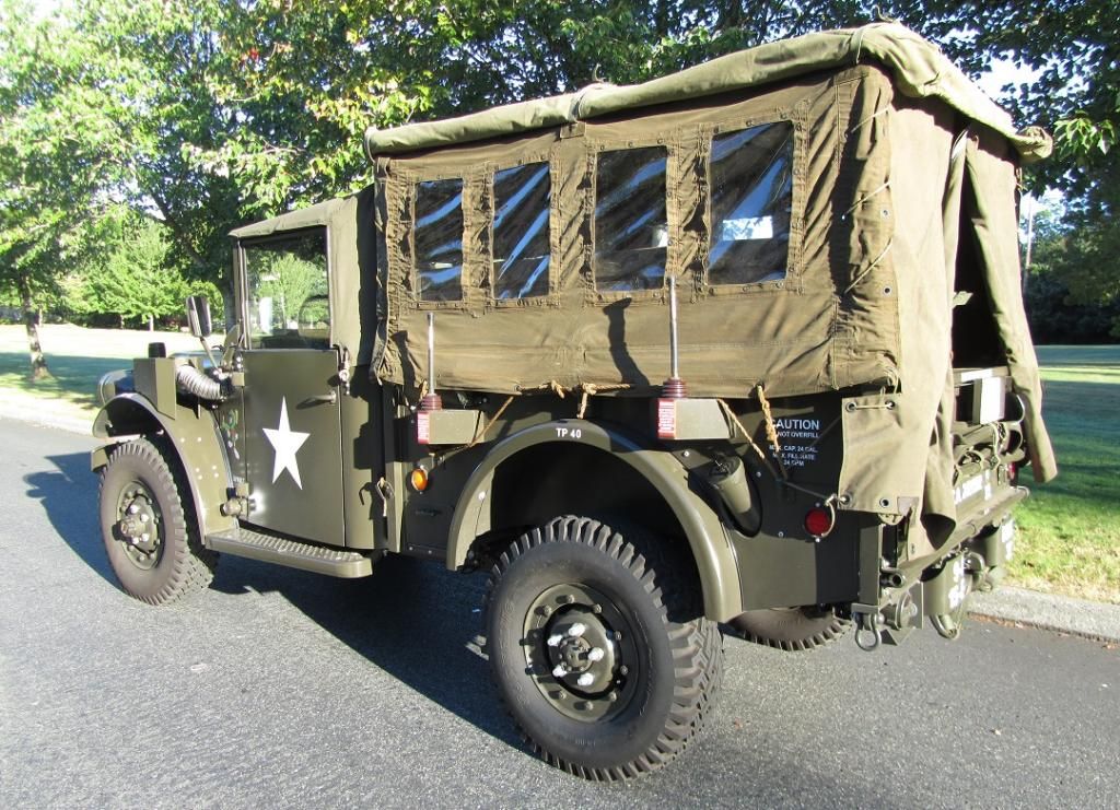

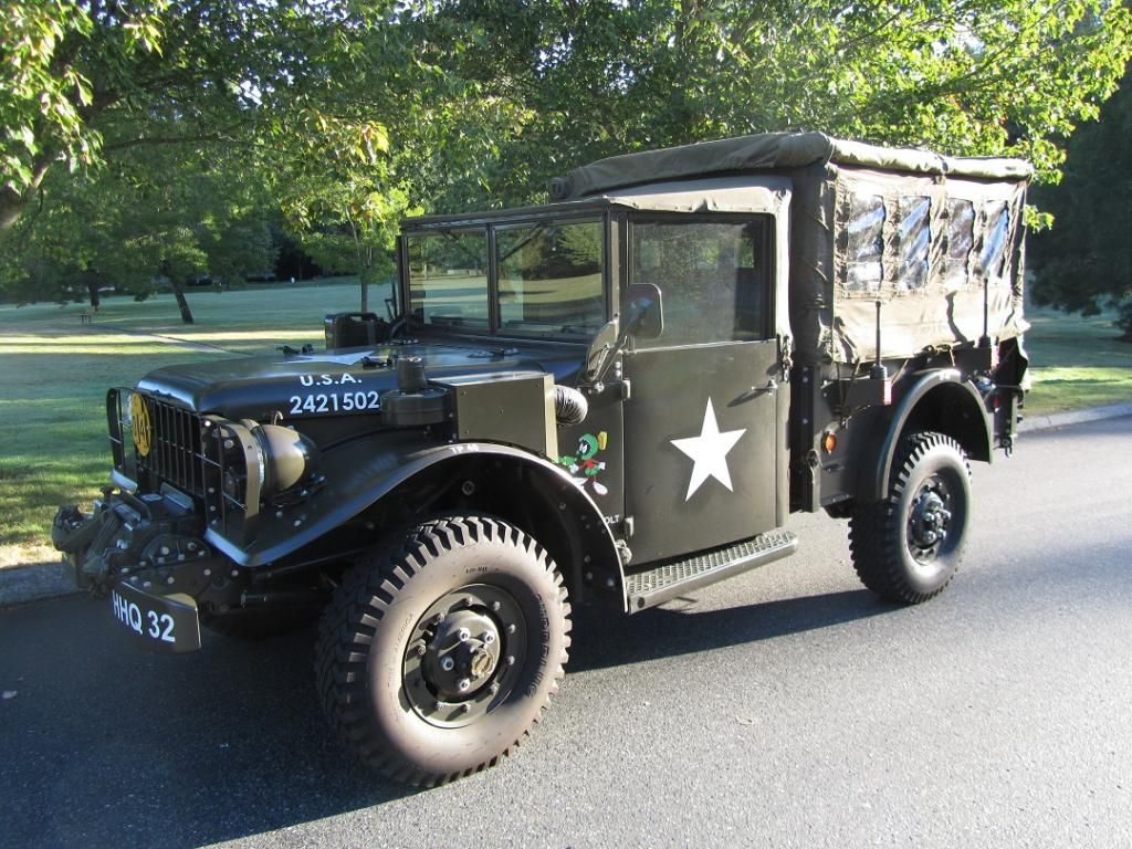

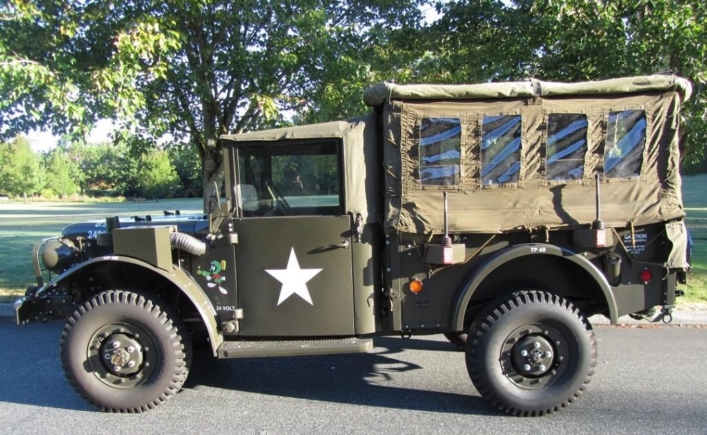

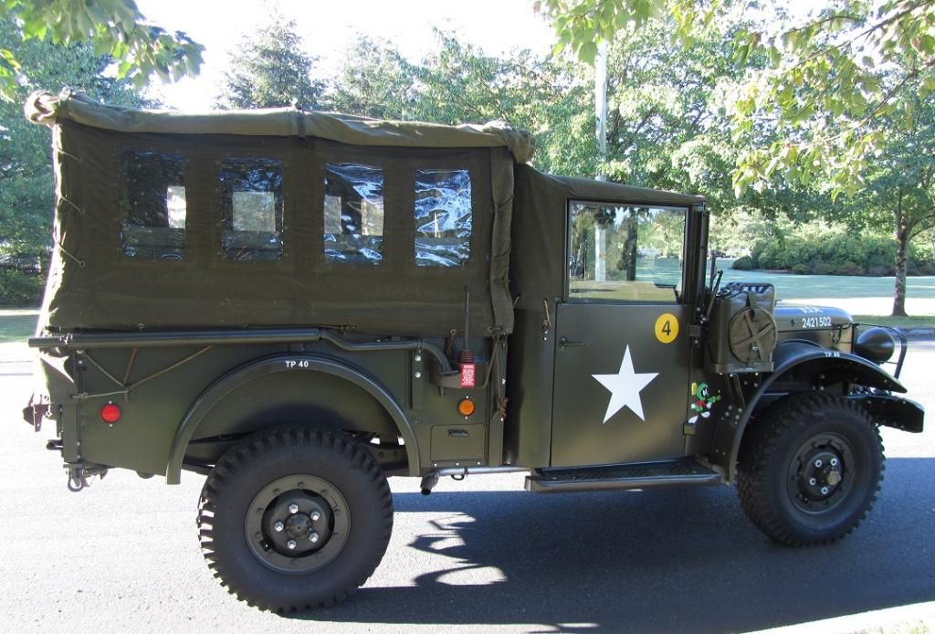

There is a Command Truck Kit for the M-37 that turns it into a M-42 Command Truck. :wink:

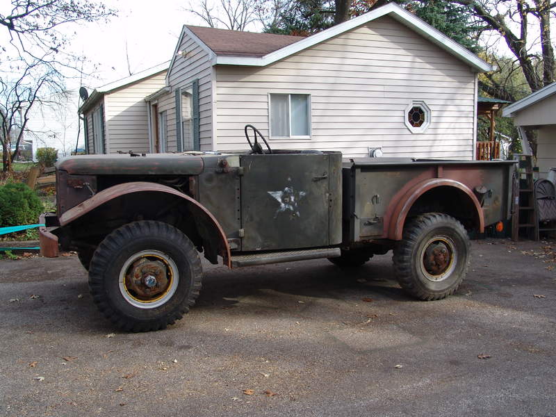

like this?
52 M-42
Posts: 741
Re: 4 Door Concept
Post by 52 M-42 »
Well, a U.S. a M-42 Command Truck looks like this:
Is the vehicle you have pictured a hybrid or custom build? Maybe a foreign produced one? If it is a U.S. military one, what was its designation? M-?
I'd like it better with a winch, but I like it.
:D
Re: 4 Door Concept
RMS wrote:like this?
That's just wrong! :mrgreen:
RMS
Posts: 930
Location: Richmond BC Canada
Re: 4 Door Concept
Post by RMS »
ya its wrong but done in good taste. in that it looks correct with proper proportions. i believe its a custom and it would have been a lot of work to join a m series nose onto a wc body. it looks like a m cowl and a widened a command car body. I like that he used the m37 box fender even though the command car rear fender matches the m37 front fender better having the same lip. it looks tubbed to fit the narrower m37 axles and running the stock seats. he could have gotten away with using the wc running boards but he built/extended m37 style boards Image
