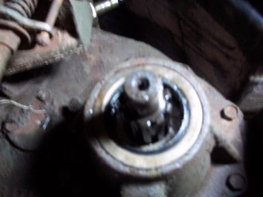

Trying again:
Re: PENION SEAL

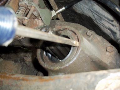

And more-again, this took less than 10 minutes:
Hope this helps!
Hope this helps!
- use screwdriver on opposite edge.JPG (19.88 KiB) Viewed 2375 times
- old seal-almost out.JPG (19.46 KiB) Viewed 2375 times
- new seal installed.JPG (15.6 KiB) Viewed 2375 times

Be sure and not get too aggressive. It is easy to crack the bore flange on the housing with heavy equipment; remember it is a casting. What we typically do with the ones that prove stubborn, (about 50%) is heat them up with a rose bud, they generally surrender quite easily after that.

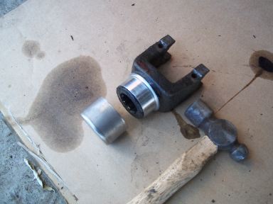

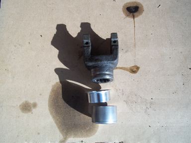

(Speedy sleeve also went in where the seal replacement was completed).
- speedy sleeve 1.JPG (16.39 KiB) Viewed 2373 times
- speedy sleeve2.JPG (17.11 KiB) Viewed 2373 times

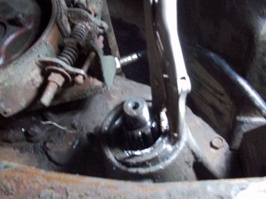

This is the tool I used to remove the old seals on the transfer case while it was still in the truck, They came out pretty easy.

This type seal extractor works very well in lots of applications also. They used to be sold off the Snap-On truck. Not sure if they still are, as we no longer have a Snap-On rep working this area.Sal wrote:This is the tool I used to remove the old seals on the transfer case while it was still in the truck, They came out pretty easy.
