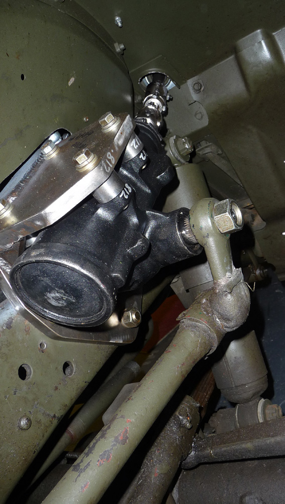

Watch the clearance between the 1st drag link and the front left corner of the steering box. Your box is mounted at an even grater than mine, and I've had a little problem. Mine first had a problem when the front left bolt broke and fell down and hit the arm, causing stress on the pitman arm. This photo was after I replaced the bolt and cleaned up the drag link gouges, and since I left the lock washer out on bottom for more clearance I installed a lock nut on top.
Then I had the spring pack bolt brake and the axle slide forward, and it took an over steer to the left to keep the wheels straight which caused the drag link to hit again and eventually cause the pitman arm to break.

Will, yes, I have that interference issue... Didn't notice it until last night, otherwise I would have mounted the box angle lower. I was attempting to minimize steering shaft angles with the steep box angle. I'm going to trim the box bracket, and leave that 4th bolt out, or thread it in from above so that it is a stud that sticks through flush with the bottom of the bracket. The hydro ram on the tie rod will be doing 75% of the work, so I think it will be ok with only 3 bolts. I'm going to adjust the left knuckle stop (another of the many advantages of Danas) so that when I turn to the right the knuckle stops the steering system before the pitman arm introduces itself to the box bracket. Worse comes to worst, I can always put a longer pitman on it, but that will tighten up the ratio even more.

I have a slightly different setup to you guys and I dont get the interference issue.

NICE! never thought to mount the box upside down... D'oH!

If you follow Tom's (snake River 4x4) instructions to mount the steering gear, you are not going to have the interference issue.
There's a picture in his website that makes cristal clear where to drill the holes for the steering gear mount.

I followed Tom's procedure and still wish I'd mounted it higher and flater. It's a good design, just a tight installation that expects everything to stay tight and in place.
