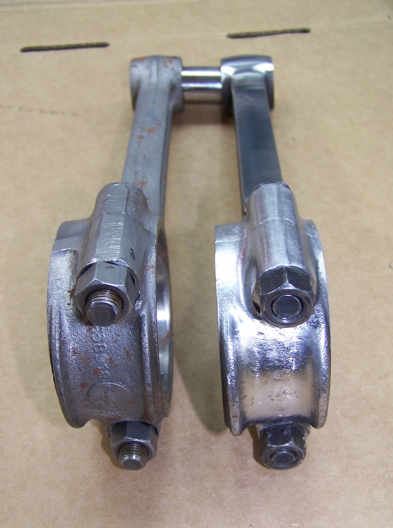

Interesting that you chose to remove the ribs from the bottom ends of the rods in order to balance. More modern rods sometimes have a sacrificial balancing "pad" on the bottom half, but I'm not sure that was the intention of those ribs.

Taking some of the ribbing off was they only way to reduce weight. I talked to an older guy that built hotrod engines when he was working. He said you can remove a lot of metal off of the bottom of the rods. I showed him the picture and he said they look great. We will see.

I hope that the old guy is right about those ribs. I might have been able to save some time and expense, but instead I ended up with a large collection of rods, trying to find six that were close enough to begin with that I didn't have to remove much metal, especially from the bottom end, to bring the heaviest down to the lightest.
Here's a comparison of the original and balanced rods:

my machine shop balanced my engine, rods, and I think flywheel too, and while I have never driven or even ridden in any other M37's, my motor does seem to be really smooth. I also keep my speed down to 40mph, with the OEM gearing and NDT's. Read about the tendency of these long stroke rods to break at "high" rpm.
I don't know where our "rods" are most likely to break, but I am guessing it is the bottom of the big end. Here, a pic of one of my rods, keeping the "ribs" intact.
Dodge did not originally balance these engines, for a number of reasons, perhaps one being that when sent back to depot for rebuild, it was too difficult to keep the internals together, and then it would have been necessary to balance them every time they were re-assembled. And better to have unbalanced but stronger rods too.
All I know is in the about 7K miles since it my engine went together, all is well. Perhaps peening yours now might be a good idea. This one must have been the really heavy rod. hal

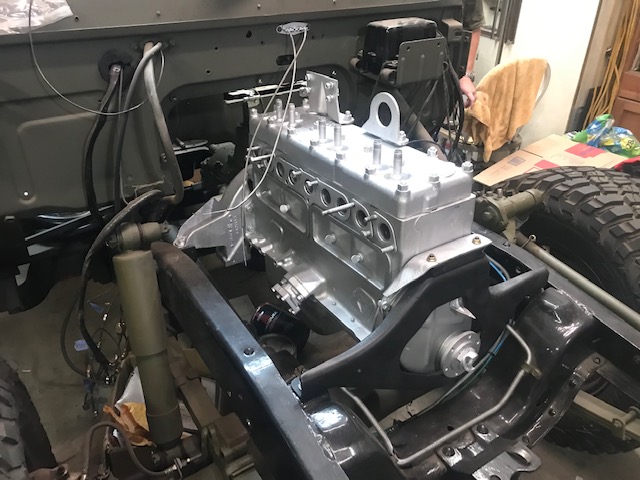

It’s been a while since I have posted an update but have been doing work on the old M37.
I got the engine back together. Put it and the transmission back in the truck.

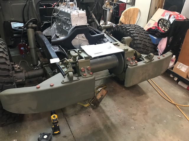

Then put the winch and the bumpers back on:

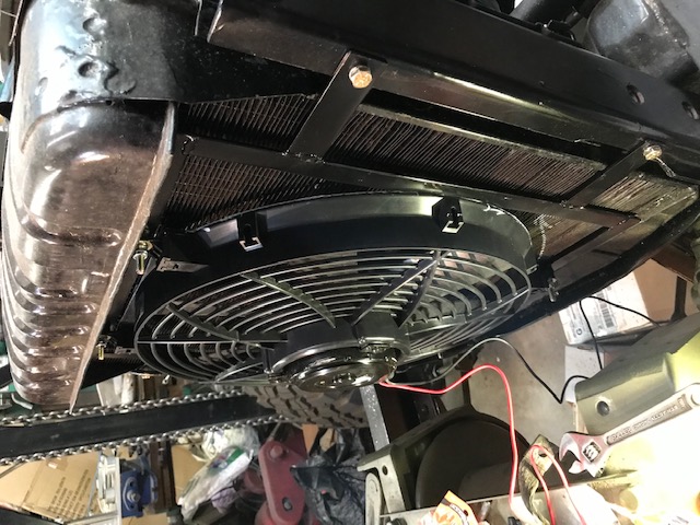

I wanted an electric fan instead of the normal fan. So, I had to figure out how to mount it.
Electric fan done:

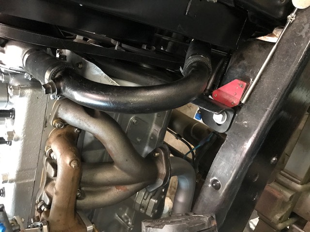

Header and radiator hoses.

I like the induction and headers. NOS or new?
