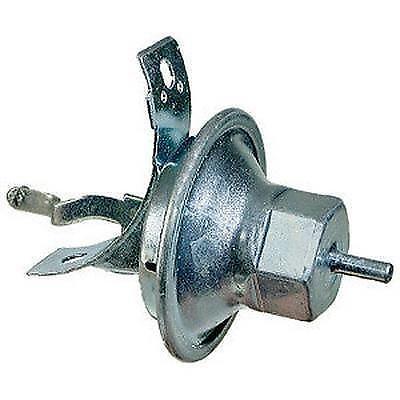

The vacuum advance timing thing does not hold any vacuum at all
AND i had a leaky hose
Replacing both parts tomorrow.

Boy i sure hope this fixes my gutless on hills problem
