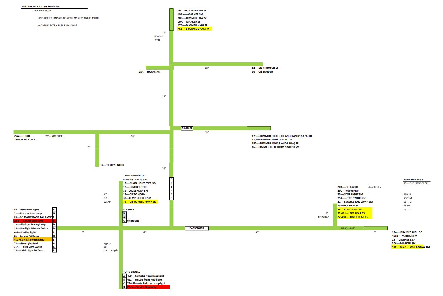

As I built the harness I caught an error in my main plug to turn signal connection. This pic reflects the fix. I still do not know how long the horn wiring group is as the harness was cut off in this section.
