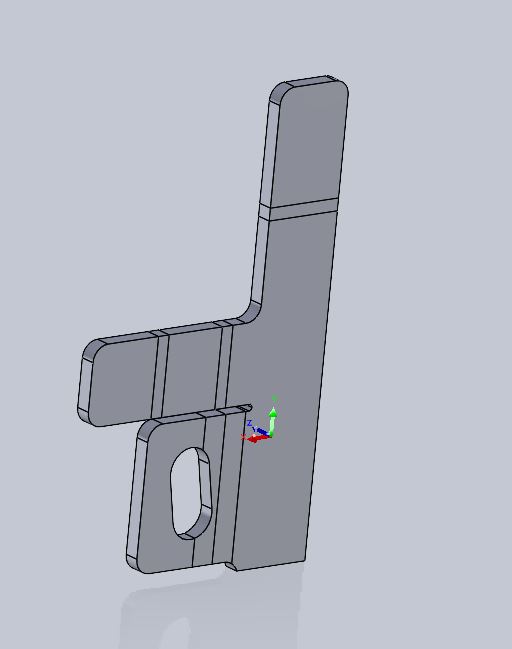

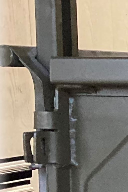

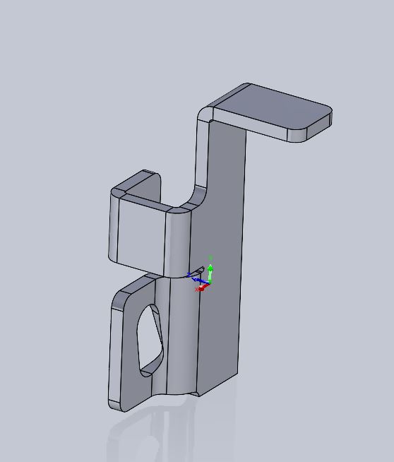

Next up were the upper corner bracket pieces that the chain loops through. I don't know what you'd call them but I bought a 3/16" thick flat bar drop, if I recall correctly and fabricated them with a vise, hammer, and other stuff. At the time, I didn't think about snapping pics but I'll include what I could come up with.
First, I took measurements of the width of the part, its alignment with the corresponding part on the truck bedside, and also included some guesses as to the non-critical dimensions. From here, I created a solid model in SolidWorks.
Tailgate Chain Loop.JPG (25.63 KiB) Viewed 10142 times
After a few attempts and test fitting the piece, I got it where I needed it then printed a flat pattern of the model.

If you are not familiar with 3D modeling software, when modeling sheet metal parts, if you unfold the model like the second pic, the software compensates for the added dimensions needed in the bends. That ensures accuracy of the part after bent. In my case, I used the 3D printed flat model to trace the steel blank then used an angle grinder to cut the part out (and didn't snap any pics). The steel blanks looked just like the flat model though. With the blanks done, I milled the slots then scribed the bend lines then clamped the pieces in a vise and beat them into shape with a hammer. Again, no pics. Sorry. At some point in the build, I had them welded to the tailgate.
Right now, this is the best picture that I have. They actually turned out much better than I expected.
Completed tailgate latch.JPG (53.41 KiB) Viewed 10142 times

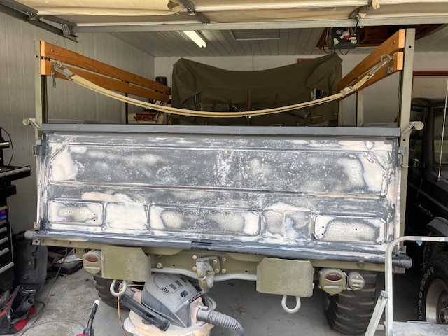

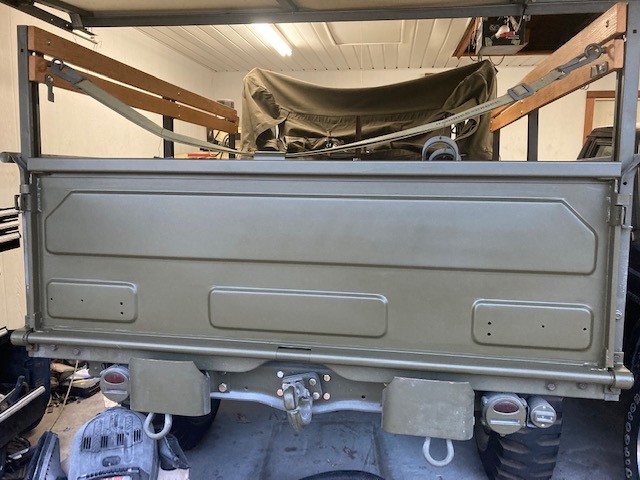

With all of the welding and trimming done, I started the much needed bodywork on the unit. I had it bead blasted then sprayed epoxy primer before using body filler. Once it was ready, I sprayed it and installed it. The filler was necessary for the distortion caused by welding, slight misalignment of the welded pieces, and pits in the metal. I would have much preferred to purchase a new sheet to start with but my friend who agreed to bend the sheet pulled this out of his drop and gave it to me so I went with it.
Now, all that is really left is to install the reflectors and the tarp hooks. I bought both from online vendors and installed the reflectors with nuts and bolts. I wanted to stay as true as possible to the original so I considered rivets for the tarp hooks but came up with a different solution since I could not find rivets with the head diameter close to or equal to the original ones.

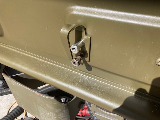

I purchased 4 typical 5/16" carriage bolts because the head shape and diameter was similar to the original rivet. I reduced the overall height (?) of the square shoulder to the thickness of the tailgate with a drill and cut-of wheel. Once done, I squared up the 4 mounting holes in the tailgate with a file. Once done, I was able to insert the bolts from the inside of the tailgate with the threads facing outside and the square shoulder flush with the outside of the tailgate. Sorry, no pics but fairly straight forward.
A typical hex nut just wouldn't look factory so I came up with a different option. I bought what I seem to recall 1/2" diameter bolts with partial threads then cut the threaded part off. Using a small cheap lathe I have, I was able to bore then tap the remaining piece of bolt for 5/16 threads. I also reduced the outside diameter of the bolt to make subsequent steps a little easier. Now that the bolt was threaded (more like a nut now than a bolt), I used by battery powered impact to drive them on. This is the only pic I have of that before cutting the rest of the bolt off.
Tarp nuts.jpg (66.46 KiB) Viewed 10141 times
