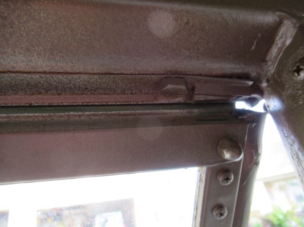

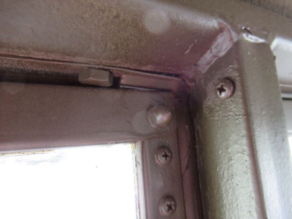

Try these:
hinge3 .JPG (33.16 KiB) Viewed 1773 times
Re: windshield problems
Thanks for those pics. It seems like my upper hinge is bent too low- causing the window to be low. Now to figure out how to bend it up where it belongs. Always something.
Again, thanks everyone.

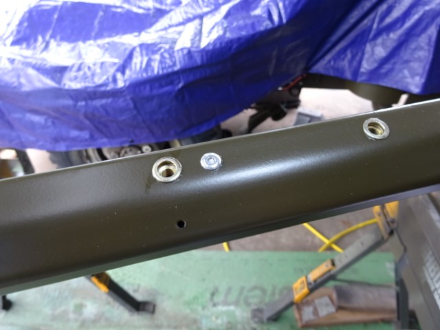

DSC01546 (Small).JPG (97.86 KiB) Viewed 1744 times
Cal_Gary wrote:Nam Vet is right on those hinge bolts. I did that after making the mistake of snapping off the first one. The threaded pilot holes fit an internal bracket that will fall inside the windshield frame and IS NOT RETRIEVEABLE. Fortunately I grabbed one hole with an easy-out just before losing the entire bracket. I ended up tapping all and replacing all of my bolts-you can see the bolt heads in my photos. Without doubt one of the toughest jobs I've done on my M37.
I installed nutserts on all of mine.
I like that 06-never seen such a thing-those look like a well nut.
