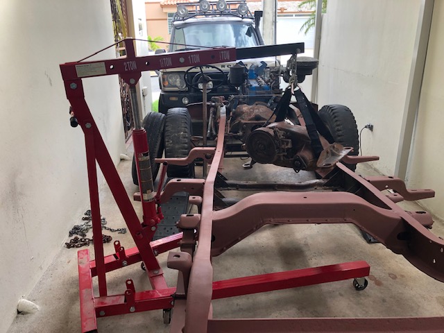

Thank you EZ8. Here is one new picture.
After a serious back injury on 8/21 while helping a cousin prepare for hurricane Laura and after many, many sessions of physical therapy, I am feeling better and strong enough to continue the project. I just removed the transfer case. Today or tomorrow I will be removing the engine so I can finish the chassis. One day at a time...

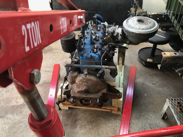

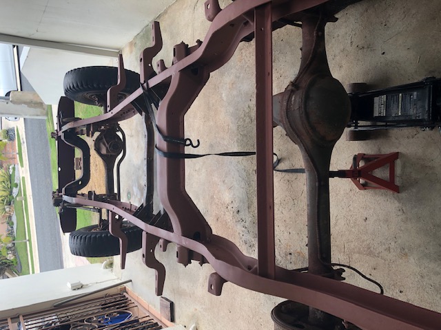

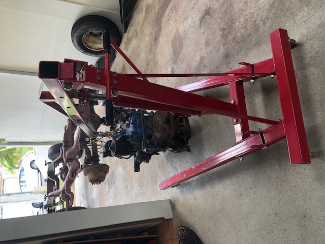

Here are some photos of today’s progress. The engine is finally out!
Tony

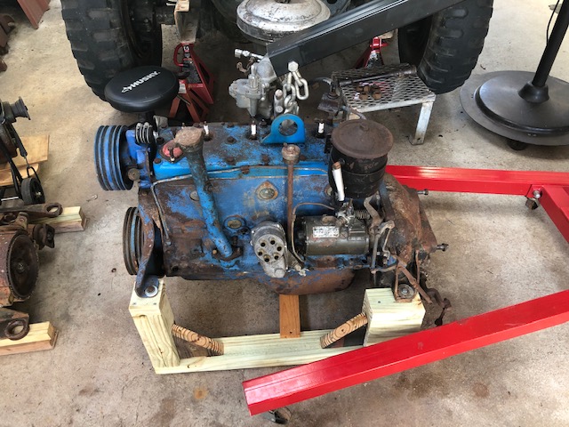

One more.

Re: 1963 M37B1 and introduction
four pulley means it has the 100 amp alternator. Not the 25 amp generator. I have that and run other things like a big extra full flow oil filter system, handles the power needed fine. Keep us posted. HC

NAM VET wrote:four pulley means it has the 100 amp alternator. Not the 25 amp generator. I have that and run other things like a big extra full flow oil filter system, handles the power needed fine. Keep us posted. HC
That's good to know. I didn't know about those alternators until yesterday. Unfortunately this is the parts truck and most of the accessories were missing. I bought it mainly for the chassis and it also included the engine, transfer case, transmission, both diffs and some usable body parts.
