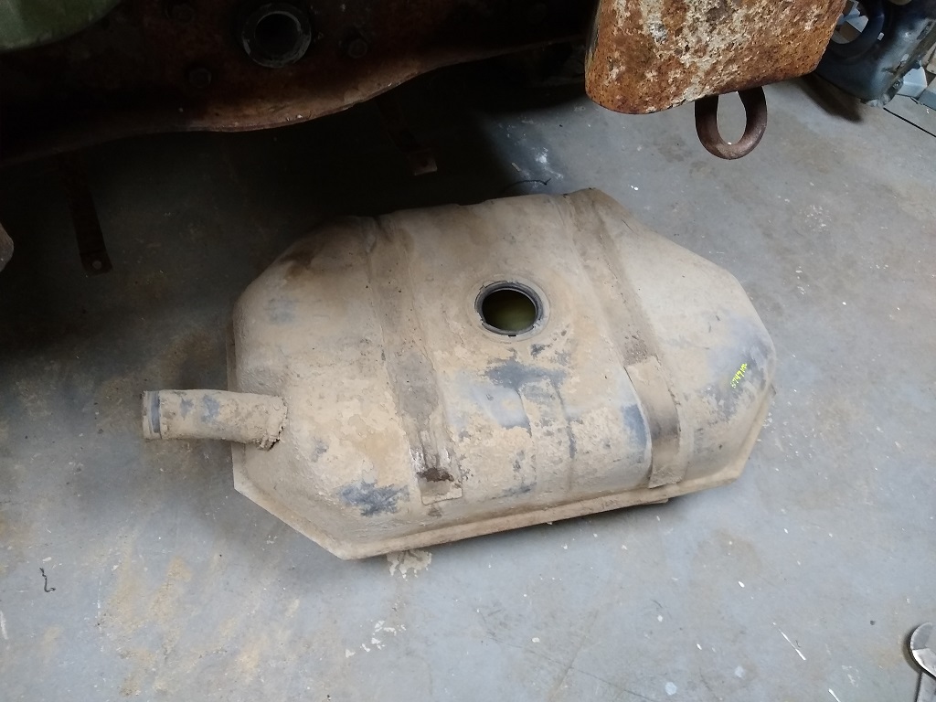

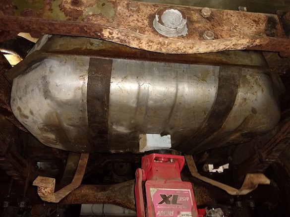

My truck didn't have a gas tank and I haven't been able to find a tank nearby so I decided to try fitting a s10 blazer gas tank. So far it looks like it shouldn't be to hard.
S10 Fuel Tank
S10 Fuel Tank
Somewhat Fitted
Somewhat Fitted

Re: 1953 M37 Project
Post by RMS »
I also installed a s10 tank. fits good. alittle smaller @ 80L vs the stock 100L tank.
ive been without a fuel gauge for 15years so if you get the 12v s10 sender working with the stock 24v gauge I would like to know.

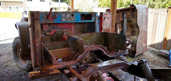

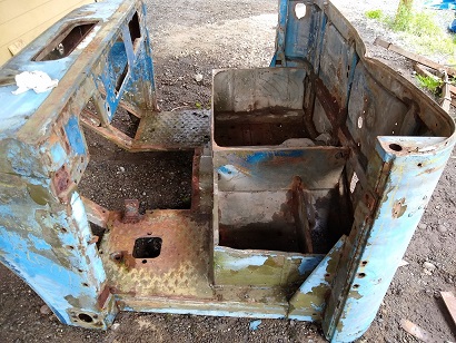

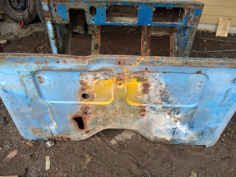

So the cab I have is pretty rusty on the floors and where the windshield attaches so I picked up another cab for free. Its better in almost all aspects except for the back since it was off the truck and sitting on its back for 20 years. I guess you get what you pay for :D .
Nothing wrong with that! I had to replace my cancerous cab too, and got a free one from Kirt Hirte of this forum back in the day-never forgot his kind gesture; indicative of the quality folks we have here!

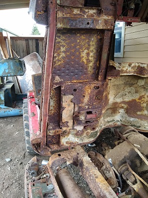

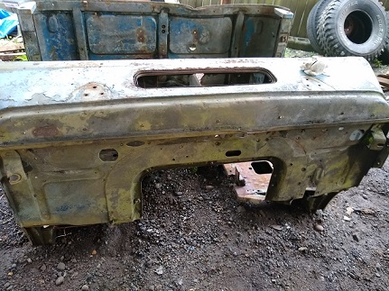

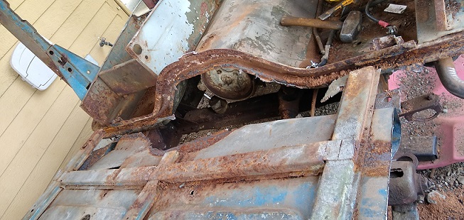

So I got the body swapped which turned out to be a pain by myself, but after swapping the bodies the more I looked at the back panel of the new body the worse it looked so I ended up cutting it off. Plan is to remove the back skin of the original cab. The bottom of the original cab was quite bad, the seams were bursting with rust if they didn't crumble at my touch.
Youch-that's a lot of work ahead.

That's pretty much how this whole project has turned out, I bought the thing on an impulse and it's been fighting me every step of the way. I think the only thing that has worked on the whole truck is the oil gauge. I'm okay at welding but don't really have the patience for good body work so I guess we'll see if it turns out. I probably won't sand blast since the budget is super tight, probably will just wire wheel it and replace the rusted out parts and treat and paint it.

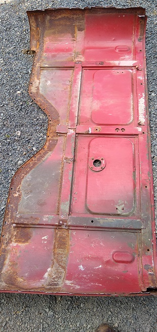

Post by Sokoji »
Thanks for all the suggestions on better ways to get rid of the rust, I'll have to try them out sometime. I got the skin off the original cab, its in a little bit better than the one its replacing but still not all that good, the more I look at it the more I think I'll just do the minimum on the cab and just look for a more pristine cab.
