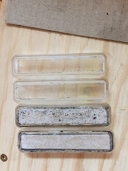

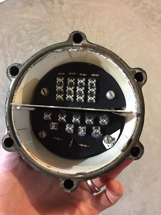

I also took the blackout lights off and modified them to hopefully retain an unmodified appearance, while making them brighter. I had a number of LEDs left over from a previous project, so I made up two arrays for each front marker light. They are mounted on a piece of PVC plastic so they can be removed and the light housings can be returned to stock if necessary. I also took the lower lenses out and removed the blackout shield inside, and then sanded and polished the lenses to remove the oxidized plastic. I think they came out okay, not perfect but then again this is not going to be a perfect restoration. Lastly, did a bit of sanding on the frame and found the numbers for the truck. Serial # is 91401417 and CAR # is 53-41171. I don't think there's much to be found out with these numbers as I guess most of the records are long gone from the military archives, but I'll at least be able to put them back on the truck when I get around to painting it.

thats fn cool. great work! how hard would it be to make a sequential array for markers that could replace the black out portion ?

RMS, I looked into doing something like a sequence when they flashed but I found that I would probably need to control it with either a microprocessor like an Arduino or some sort of integrated circuit. Since I have no formal education in electronics and just learn as I go, I decided to keep it as simple and low cost as possible. My main intention is to improve the systems on the truck where I can, while still maintaining the classic/antique appearance.

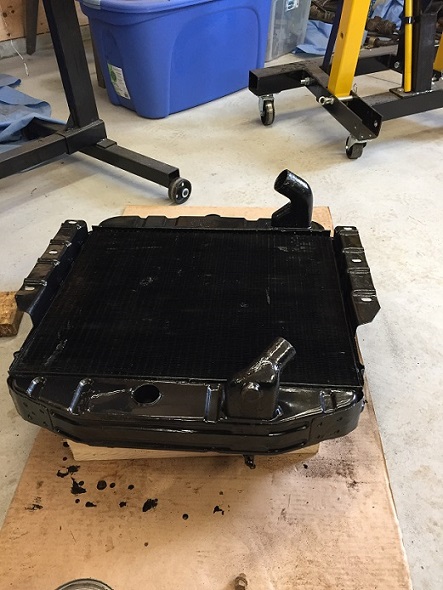

As for the rad, thanks Calgary. It turned out to be fairly easy to solder the rad, although the cracks were all down in the bottom tank so I didn’t have to touch the tubes which cut down on the work involved.

Just a little update here. Since the last post on here, I have reinstalled the radiator and new hoses and replaced the fan belt. ( That took several trips to the local NAPA... too short, too long... just right!)
Everything was also given a cosmetic restoration.... ie. a coat of black paint.

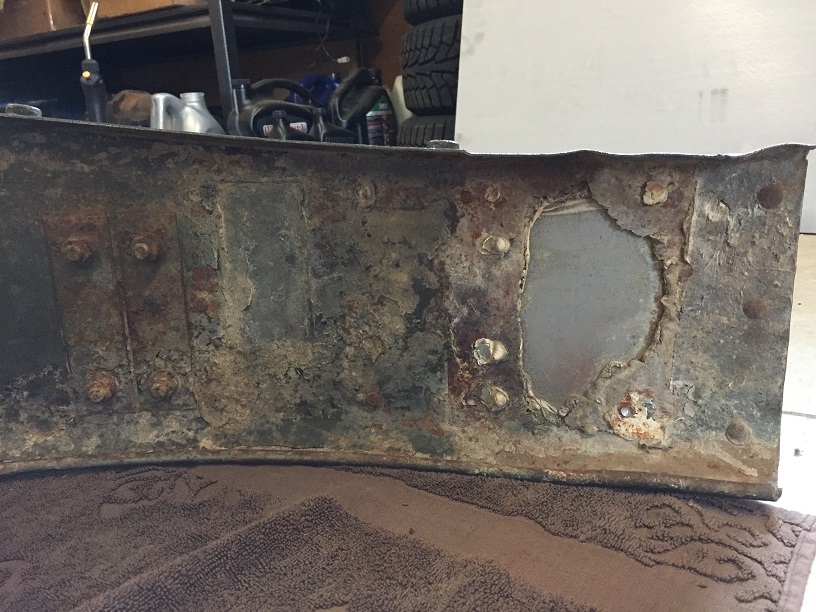

I have also removed the passenger side fender since it was pulled down slightly from a bent mount off the frame. That was quite a chore since most of the hardware was solidly rusted, especially the bolts that sit in the channel shaped bracket for the lower rear fender mount. Those had to be cut out. Taking the fender off also allowed me to get a close look at the military’s method for rust repair.., sheet metal, rivets and copious volumes of seam sealer in between. No paint though.
Anyway, I’ll mig some fresh metal in, and redo the lower mount on the fender and see where we go from there!

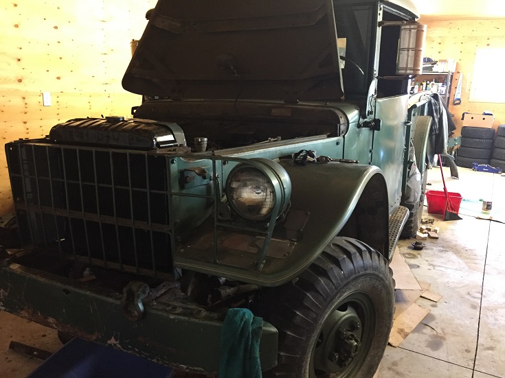

And here are a couple pictures..

I love your little LED modification. Its going to be interesting to see how it works out. You may want to put some sort of diffuser in there to blur out the pixels.

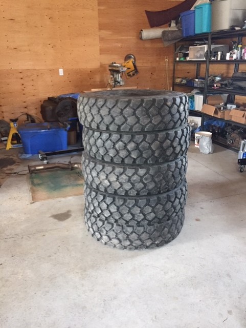

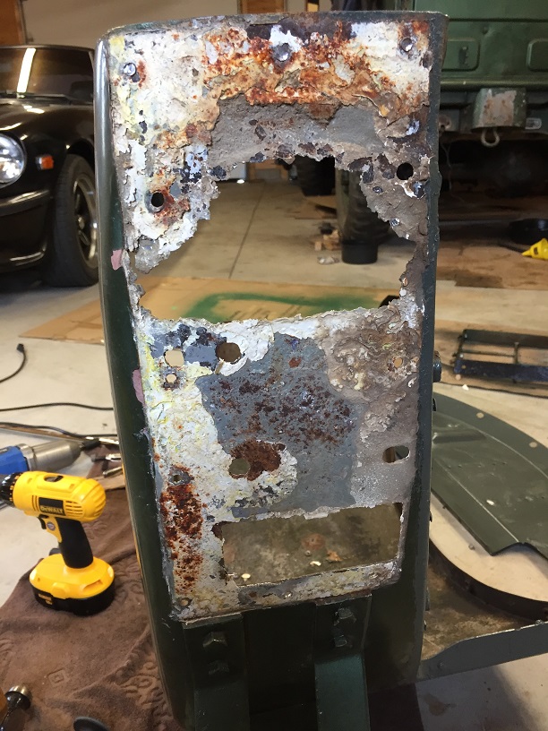

Just an update to let you know I’m still here and working on the truck. Made a recent purchase of some military surplus Michelin xzl 9.00-16s, and am now working on breaking down the old rims and tires. Looks like the youngest ndt was a 1970 vintage, while the spare tire was original, 1952 dated with the bead lock clips and all. Pretty amazing they held air at all!
I think the new Michelin tires are going to look great, and they keep with the military theme.

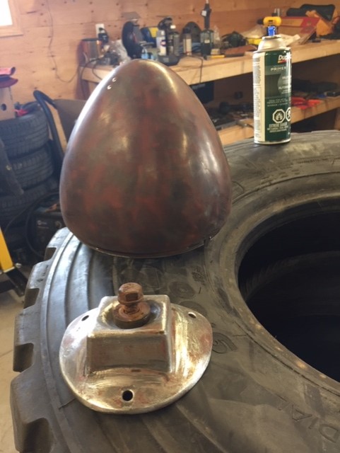

Also bought a new headlight bucket as the one I was going to repair was far too rusted out to be saved. Also happened to be full of old wasp nests, but those seem to be found everywhere on this old truck.
