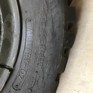

Gotha, but they are gone soon.
Tire and Numbers.jpg (17.06 KiB) Viewed 1708 times
Notice the checking ....

I'll bet it says "do not mount on 16" wheels" somewhere on the sidewall, also!

Nope!

And I was standing next to that, glad I didn't kick the tires!!! :lol: :lol: :lol:

I think you would have been OK?

If that were mine I would put the jack under the axle but not jack it up until I pulled the valve stem out and let all the air out. That is sort of like playing with 50 year old sweating dynamite, Anybody into explosives or mining will know what I am talking about. It can go off just by touching it. Can also give you a hell of a nitro headache!!

When the glycerin beads up on the solids, I've seen it. Thanks Rick.
