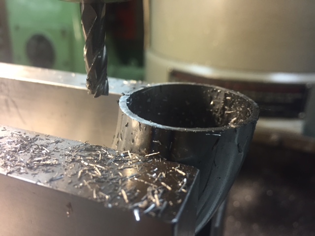

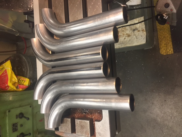

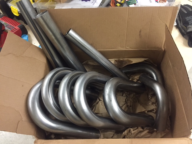

It's been a while, I didn't want to post pics till i had a good idea of what i was doing and if it was going to work. Well, looks like it's going to work, it's certainly more work and more time than i expected it would take, but what project isn't? Last time, i was waiting on tubing. I ordered all the tubing from Columbia River Mandrel Bending (here). I ordered most of the tubing in 180* bends, because you get the most bend/$ that way. I also ordered a one stick each of straight 1.5, 1.75, and 2". It's only mild steel, because i figured it would be easier to work with and cheaper to buy initially. If i had known how much work would be involved i probably would have gone stainless from the start, if I build another one it will be stainless, because this isn't something you want to rust out after a few years.
Here are a few pics of what showed up in the box.
I initially cut each of the U shape pieces in half on the band saw as near to the center as i could get, and then surfaced them all to the same height on the mill with a carbide end mill.

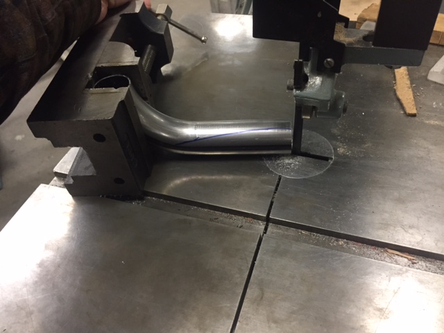

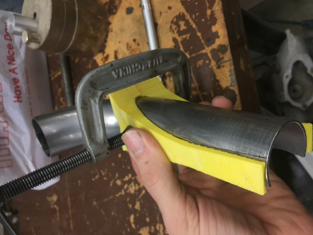

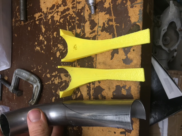

Here's a couple pics of how i marked and cut the pieces, using the CAD file to create a 3d template, printed the templates from PLA plastic, and then cut the pieces and angles on a band saw.
They may not look like much laying there
but when you clamp them onto the pipe, all you have to do is trace around them with a marker and you have a perfect cutting line. no more "cut, test, cut, test, grind, fit, grind" it's just cut once and the pieces fit perfectly
using a movable vice to hold the leg vertical during the cut, ensures that the saw blade will follow the line on the bottom as long as you are careful to follow the line along the top.
