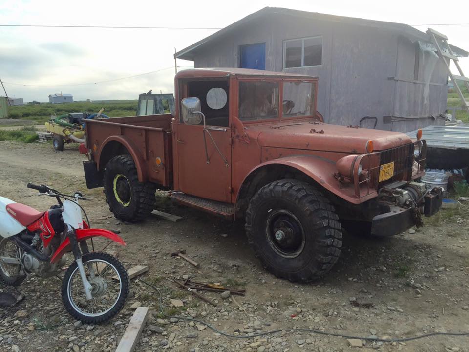

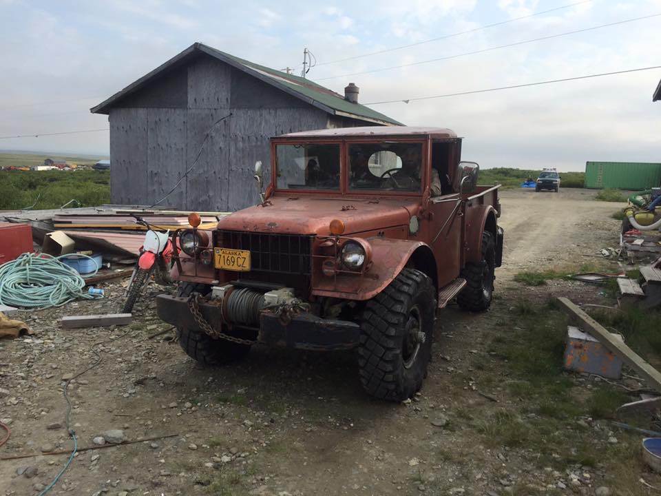

considering 325/85R16 michelin's on my first M37
Re: considering 325/85R16 michelin's on my first M37
I knew I could count on RMS to come up with the pictures... I looked all over the place but didn't have any luck. Thanks RMS
Jess
Jess
isaac_alaska
- Posts: 557
Wow! those tires look right at home on that truck. no chains necessary! and that certainly looks like Alaska.
i wonder where it's living now..

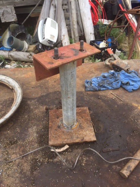

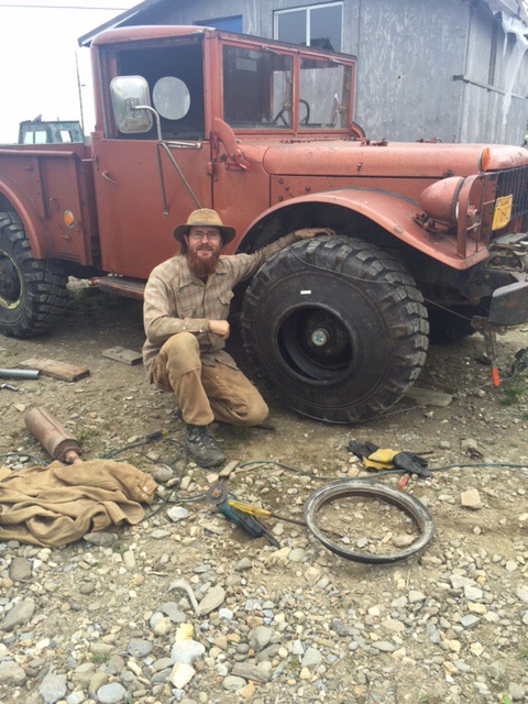

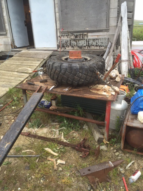

Here I am fixing my booboo. I had to slot the flaps to get the valve stems to line up, cause I couldn't find tubes with centered stems that were big enough for my tires. (I'm absolutely open to suggestions if anyone has an idea if where to look.)
I didn't use enough rubber around the valve stem so the tube is trying to herniate through the slot in the rim. The new flaps I ordered from Lucas were about 2" narrower than the flaps that were already installed, so I used the old flaps which were still in good shape. I'm using the new flaps to cut a section out of to go around the valve stem and keep the tube protected from the slot in the rim.
I put a come-along top and bottom to pull the tire back out of the way so I can get the ring on and off. I also built a work table out of scraps in the yard, which does the same thing, and makes tire changing fairly easy.
*edited because photos were rotated*
