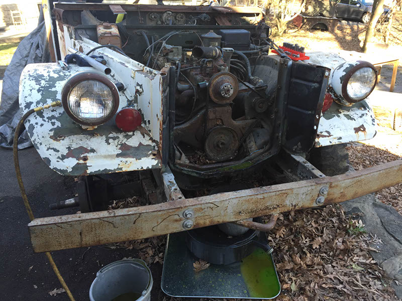

OK so I was out there today with my dad and we tried to get the donor engine to crank over. She's seized. I know she runs because I drove it on to the trailer when I last moved it about 3 years ago. She sat in the weather for 2 of those years and I think the cover I had on it may have blown off. Long story but it looks like there may have been water sitting on the head. Not much though. She was covered somewhat. Anyhow I pulled the plugs and poured Seafoam down there to start. Let that sit a few days, did nothing. Went and bought some Marvel Mystery Oil and poured that down each cylinder today. Tomorrow I am going to go out there and try to break it free.

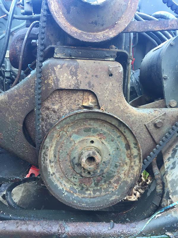

The question I have is how exactly are you supposed to hand turn the engine? I removed the radiator to expose the front pulley. It looks like there is some kind of hand crank mechanism which I don't have of course. Also it appears to be a 1 3/4" nut, possible reverse thread? I put a breaker bar on it and tried to turn it clockwise and the nut started to free, but not turn the pulley with it. Here's some pics to show you guys:
This is the donor :)

This is the pulley I am talking about:
Donor Front

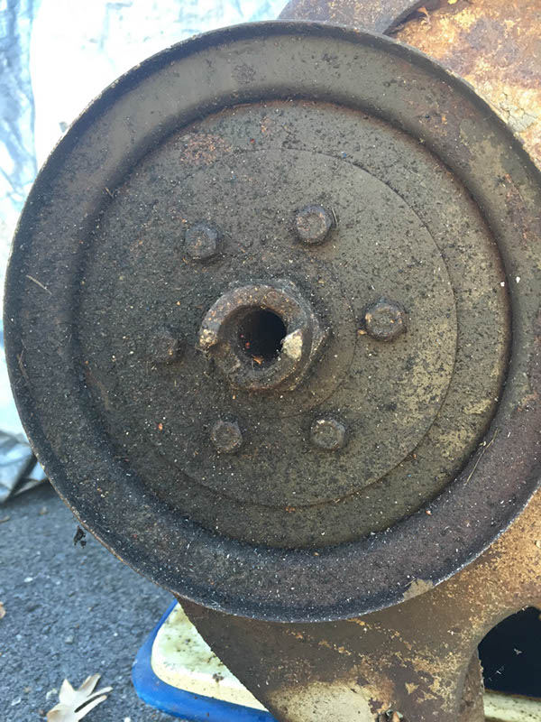

Another odd thing I noticed was that the pulley is different than the one on my blown motor. That one has six bolts around the inside, where the one on the donor only has two bolt opening with no actual bolt in it. Am I missing something here? Here's a pic of the other pulley:
Crap Motor Pulley

You mentioned that you pulled the spark plugs to put Seafoam and then Marvel oil in the cylinders. Did you re-install the plugs, because they're in place in the first photo and in the video? Or were those taken before you got started? Even if the compression is minimal, it will be a lot easier to rotate the crank, especially by hand, with the plugs removed.
The cranking jaw at the front end of the crankshaft should be turned clockwise when viewed from the front of the truck, facing the engine. There's a long hand crank handle for use with these trucks (non winch) that goes through the bumper, but you should be able to use a socket on the cranking jaw instead, since you've got the front end opened up. I don't have a jaw handy to look at, but the right hand rotation suggests that the threads are right hand as well, not reverse (i.e. left hand).
The pulleys on both of the T245 engines in my shop have six bolts, and the pulley hub behind them looks like this:
The ORD 9 SNL G-741 parts catalog calls for six (6) screws and washers to affix the pulley to the cranking jaw hub.
I'm not sure what sort of pulley you have on that engine, but I don't see how it is fixed to the cranking jaw hub. The two holes don't appear to be at the right diameter to match up to the holes in the hub.
