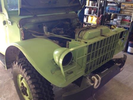

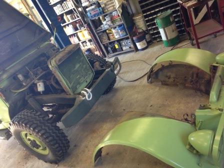

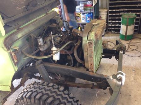

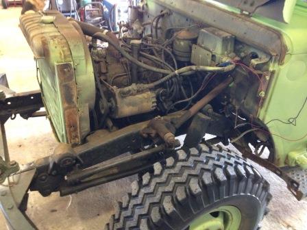

Ok in process of pulling front clip off an pulling power pack out. Trans needs work as well as few things on engine, was just as easy to pull all out
- Pulled in shop, all wiring is gone except for ignition
- m3710 - Copy.jpg (31.31 KiB) Viewed 4343 times
- Pulled front off. Only had to cut the bottom 4 bolts off the rear fenders. This took less than 30 minutes, no joke piece of cake.

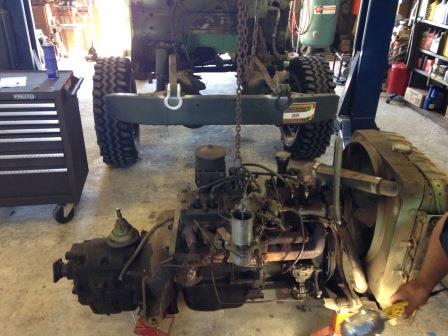

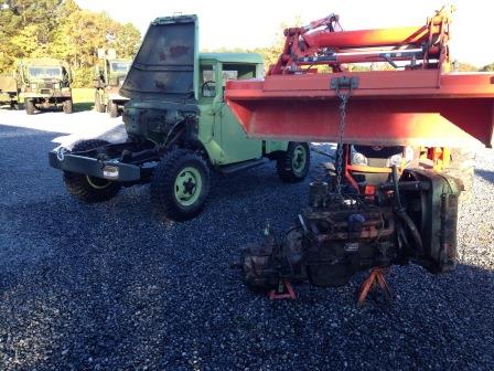

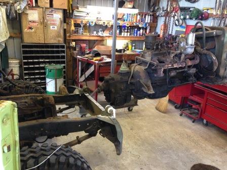

All pulled out and ready to be power washed. Whole job from removing front clip to motor sitting on floor was 2 1/2 hours. I swear takes that long to pull a riding mower engine off.
- m3714 - Copy.jpg (43.16 KiB) Viewed 4344 times
- m3715 - Copy.jpg (38.02 KiB) Viewed 4344 times

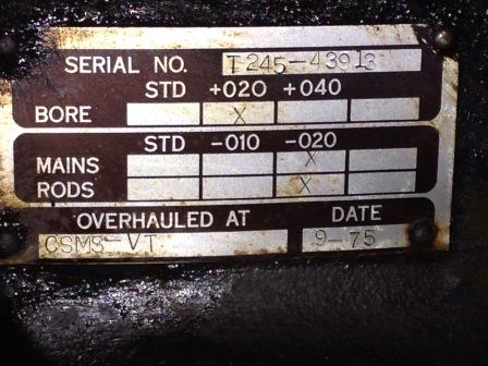

- interesting rebuild plate on motor

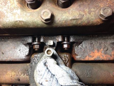

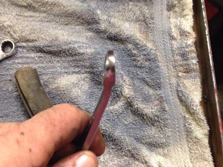

Compared to of the other equipment I've worked on in my life this is nice. Except for the clutch linkage, everything was disconnected from top side. Got all power washed tonight and broke all the nuts loose on the exh/int manifold. Modified a box end wrench to fit the center 2 nuts ended up working well. Just ground a taper on one side to fit between end of stud and intake. I have a couple pics will post tomorrow, may help someone else with the idea.

Took old truck and engine outside to power wash. motor and trans is about 3 different colrs, Blue/silver and green. I used one leg of the tow bar to push pull in shop with tractor. Worked pretty good. I broke loose all the nuts on the int/exh. I ground a bevel in a 6 point wrench to get center 2 bolts as open end or tubing wrench wouldnt break loose.

I had to chuckle when I saw the modified wrench. I have one drawer in my roller cab that has some of the wildest looking modified tools you could ever imagine, but they work.

If you would of removed the intake manifold first, the two nuts holding the exhaust manifold would have been accessible with a socket. I would recommend taking these two apart so that you can service the heat riser damper, this will save a possible headache later on down the road when summer temperatures come back.

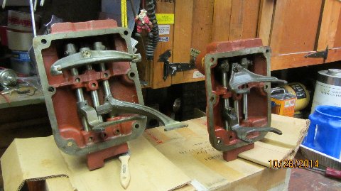

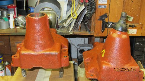

This will help you I. D. your transmission tower F18. On the left is the late model tower (NP420) and on the right is the early model tower (88950). You can see on the later model that there are 2 pins that hold the shifter in place while on the early one as Burt said has only one pin. Also you can see from the 2nd picture that these towers are NOT interchangeable between models. I had the same problem as you with the shifter rotating . Only difference was my pin fell out and didn't break. I installed a drill bit in it for a temp fix until I get a chance to change the tower out.

Great pictures. Mine is definetly older style. Where the pin hole is on the shift tower is a huge weld, pin hole must have got cracked or wore out. I may be able to fix the tower if I clean off all that weld and see what happened.
The upshifts are fine, but the down shift bewteen 3rd and 4th, wont happen unless play with throttle/clutch and grind some. Just reading some about these and havent looked for them yet. Are synchronizers avaliable or even worth doing?? Again, havent looked inside so just wondering really.
