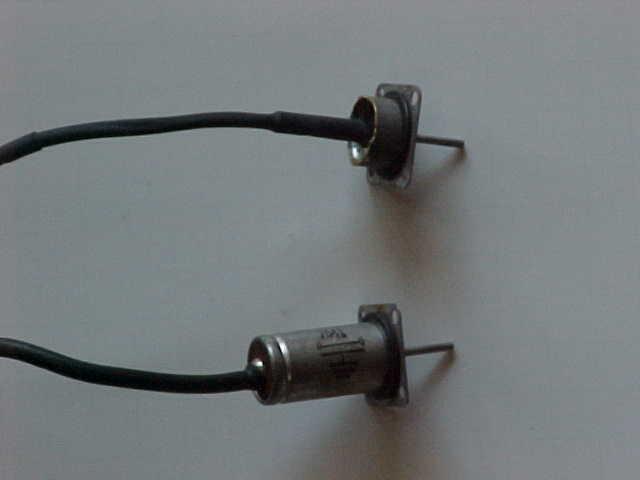

Re: Points Issues and Distributor Suggestions?
If you want to keep the original connector on the distributor then you just eliminate the capacitor from the square plate inward and solder a wire directly to the pin in the middle of the remaining square plate.Just do a search here for "distributor capacitor". One of our members already posted a public response to your question. I'll post his photo of the original capacitor below the modified unit.
Bottom is original capacitor and above is the modified housing and the new wire soldered directly to the pin.
If you are not interested in keeping the original connector functional at the distributor then dis-assemble it and install a new wire from the switch Douglas connector (at the dash) to the + terminal on the coil. You could cheat and splice/solder a short add-on section near the distributor but if you aren't sure how old the original wire is then it's best to run a new wire all the way.

cuz wrote:If you want to keep the original connector on the distributor then you just eliminate the capacitor from the square plate inward and solder a wire directly to the pin in the middle of the remaining square plate.Just do a search here for "distributor capacitor". One of our members already posted a public response to your question. I'll post his photo of the original capacitor below the modified unit.
Is the capacitor actually required for normal operation?

The capacitor is not required, in fact your engine will run better without it and it is 1 less component to fail if eliminated. You would only need it if knocking down radio interference is a issue for you.
The photo of the elimination method above will work, but it wouldn't be the method I would use as it's another connection and another possibility for issues. I always run an uncut 14 ga. wire from the positive coil terminal straight through, no soldered connection. The attaching nut goes right back on and all looks exactly original. There will be a connector in the #12 lead a foot or so from the distributor that provides a disconnect point.
