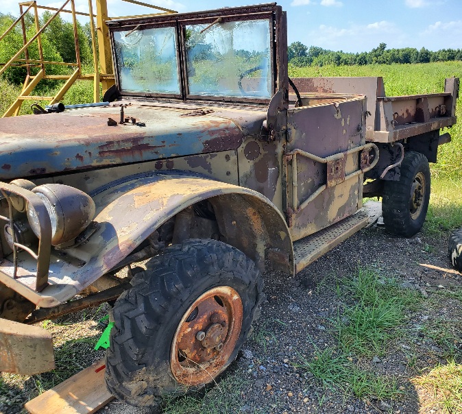

Went to a local metal supply business today looking for materials to duplicate my missing tailgate for the 708.
I need 6 feet of 1.125" diameter bar. They required that I buy 20 feet and pay a cutting fee.
To get 6 feet x 18 inches of 10ga sheet, they required purchase of a 4 foot x 10 foot piece, plus cutting fee. I think they were hoping I would spend thousands with them - they kept repeating how expensive this was going to be. I politely declined.
Got two rims dismounted and ready for media blasting today. New front tires should arrive Wednesday. Once I get them mounted after paint cures, I'll be able to move the truck under cover.

I like tall, narrow directional tires. Two STA 1050-16 tires arrived for the front of the 708 today.
9 inches tread width, a bit over 38" diameter, and directional tread depth is 19/32". A bit more shallow than I would wish, but I knew that on the front end. So far, so good. I look forward to seeing them on the truck - at which point it will be mobile around the shop and yard

Planning to sandblast two rims Monday
Do cosmetic repairs Tuesday and Wednesday
Prime Thursday
Paint with 24087 Friday
Let it cure over the weekend
And mount the two front tires on the following Monday or Tuesday
At that point, the truck will be towable, and I can get it under cover so heat and rain won't be such a problem.
Next step, mounting the winch bumpers (may do that while the rims are curing)
Then refurbing the hood.
One step at a time, and slowww, too slowww
