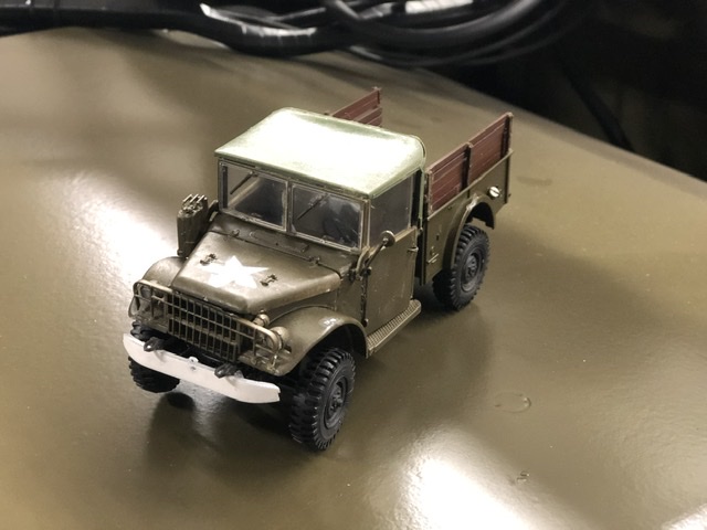

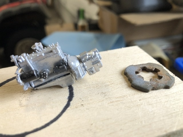

Pretty detailed….but very, very small.
M37
YEAR: 1954
UZIS9MM
Posts: 82
Joined: Fri Jun 26, 2009 11:10 am
Location: MPLS, MN
Re: Grandpa’s M37
Post by UZIS9MM »
You're going to need some hella small tools to work on that beast!

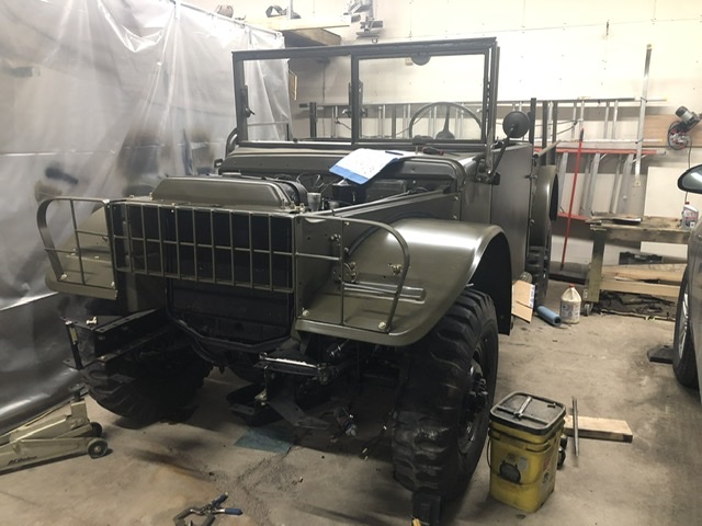

Finally got a bunch of parts back from the blasters. Another trip to MWM is in order too. But I did drive it up and down the street on Sunday waving to the neighbors!
