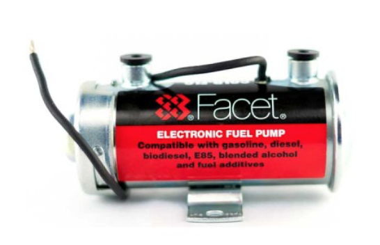

Installing a 24v electric pump for the gasoline. Tired of the mech pump with its issues, ie. vapor lock with the summer temps.
This one has the 1/4" 18tpi which should do the trick.

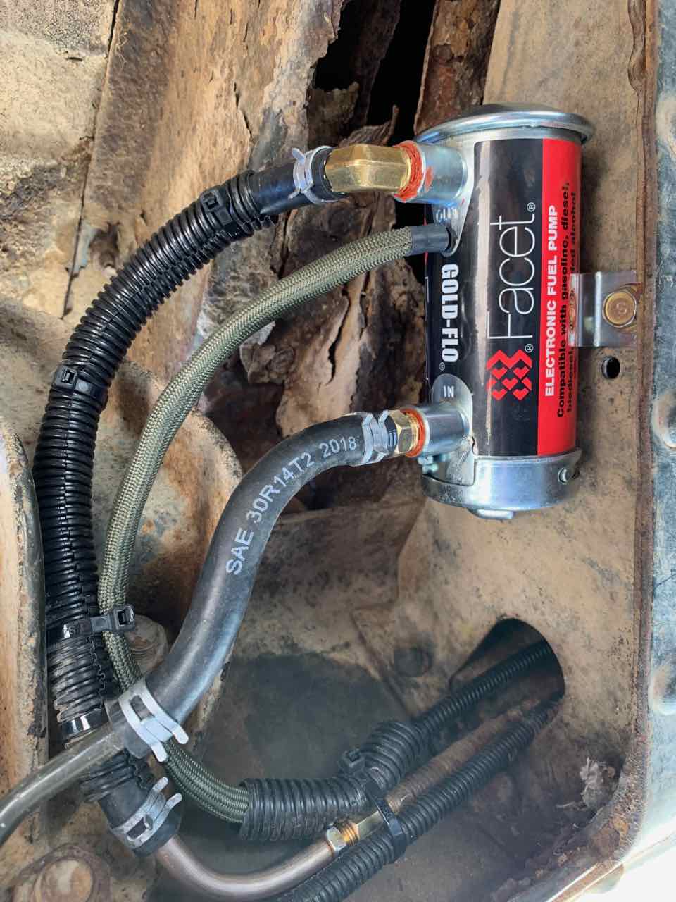

Got the 24 volt electric fuel pump installed today. Had to use the Mityvac to get gasoline to the pump. Apparently there is a mineral oil inside the pump for shipping. I drained this out and all was good. Hopefully there will be no more vapor lock issues. Vehicle drove fine in the heat. Stopped several times, and headed on my way with no issues. $97 with shipping was $107. Beats the cost of a tow. checked the pump pressure at the input to the carburetor, it is at 4.5 psi.
