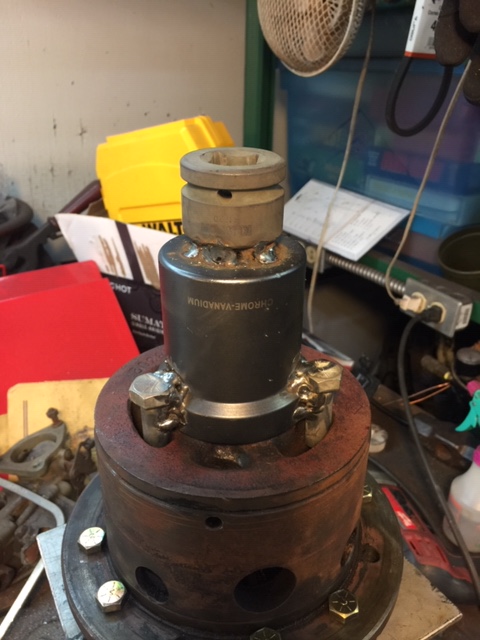

Frustrated!!
I have been trying to get the differential apart so I can do the spider gears, etc. I don't like to be defeated!! :? I even welded up this nice fixture to hold the diff solid:
I read one of Charles's old response to a diff rebuild and he mentioned that they need to be heated to near 600 degrees and to use a long lever attached to the tool to do a slow pull to loosen the interference fit parts.
Using a laser temp tool to measure I could only get the thing up to just over 400 degrees by using two MAPP torches. All I accomplished was to try and rip the vise out of the work bench. :evil:
Contacted Charles and he can do this part for me if I like. Been thinking about it. I might just call it a day and order ARB air lockers. Comments?
rickf
Posts: 437
Re: SC M37
Post by rickf »
The mapp torches are not hot enough to heat the casing fast enough to expand it before the inner part also heats up and also expands. When that happens you are basically at square one. This is a job for an oxy-acetylene set with a rosebud tip. ARB's are a real nice way to go if you can afford it. You will have to drill and tap the housing for the air lines.
