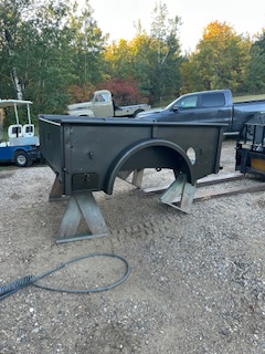

Well I finally couldn’t take it any more and have decided to give the old girl a face lift. It must of been a slow day on the base and someone must of said go paint the truck. Well that paint is all chipping off so I’ve decided to sandblast and paint it. I just purchased the truck a year ago from a person who had plans to swap the body onto a 2003 Dodge with a 24 valve Cummins. He lost interest and I bought it. The truck is all original with no rust so it seemed a shame to convert it. The grandkids and I have a lot of fun driving around the farm with the top off. I thought I would just share my restoration of it. Here is a picture of how I first saw it.

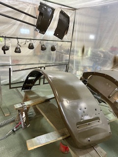

So I started stripping it down and painting

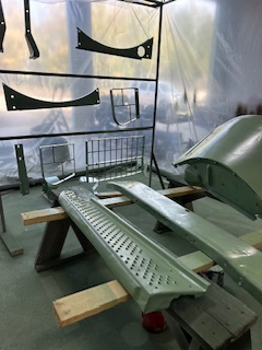

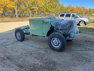

Got some more painting done and the parts are on the way from Midwest Military.

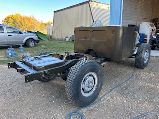

Interesting tire choice...brand and size? Nice snow tread...

They are just what came with the truck.16/9 and are about 35 inches tall and are recapped. Will just keep them until I get a flat which I hope is never.
