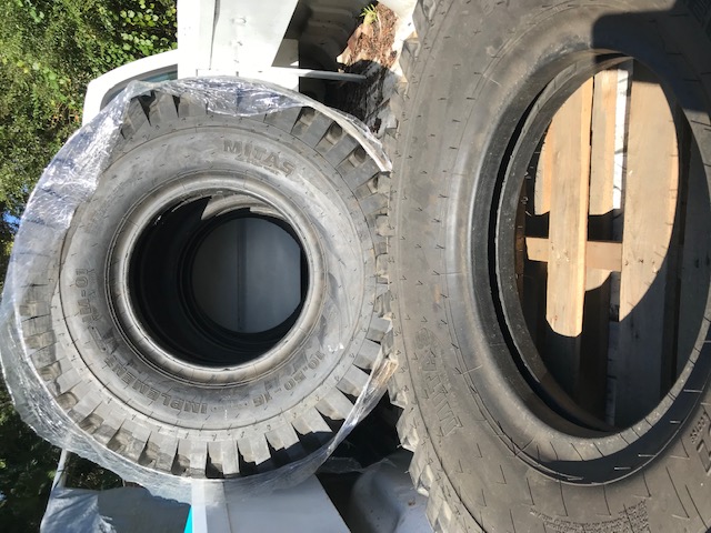

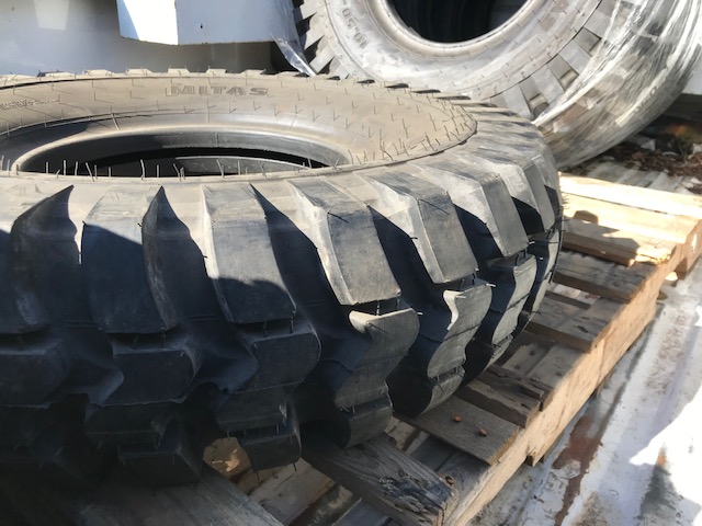

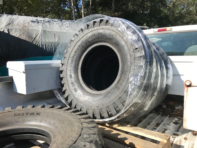

As a result of this thread and SOTVEN’s recommendation, I went on a hunt for some of these tires. I found five of them in a warehouse in Norfolk, VA. I picked them up at the freight terminal this morning here in Jacksonville, FL. They are really nice; deep lugs, a couple inches taller than my NDT’s and maybe an inch wider. They are made in Czech Republic. I’ll upload some more photos and a report when I get around to it.

U404S,
I'd like to hear the story about how you found 'em, and a road test
