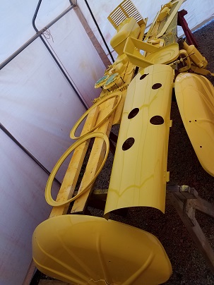

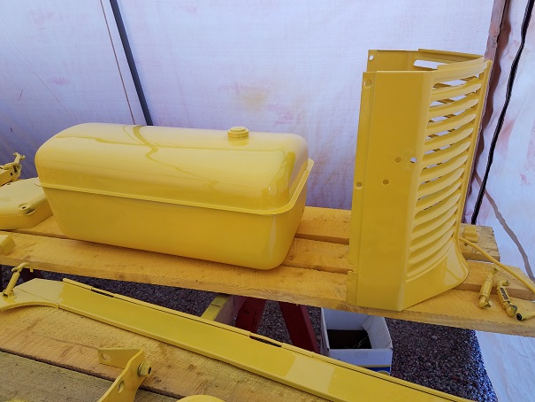

So to follow up. I did tear down the engine. It was stuck pretty good. Put it back together with some spare parts I had on the shelf. Working on getting it running now.
Got the compressor freed up. Wasn't stuck hard. Hopefully it will work. Couldn't find a head gasket for it so I made one. Crossing fingers it will hold.
And got my plug wires squared away! Found a set that should work great. EBay, no idea what they go to but the threads were right and just long enough. and $30 so worth the gamble. Had to modify them a little but I think they will work and look great.
Also started painting parts. Got the tinwork and a bunch of the small parts painted up.

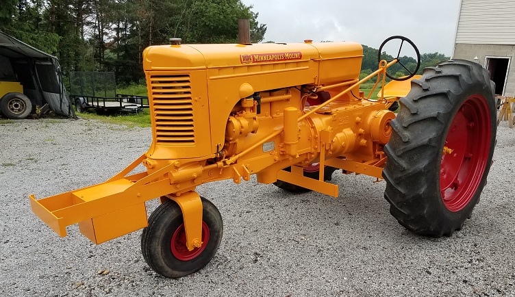

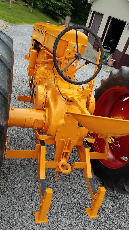

And to toss on a couple pics of one of the other ghost tractors I was painting.

Man I love those pics,nice paint.
