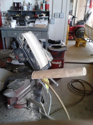

Been modifying a new shovel brought home from Topeka. After prepping it with linseed oil I discovered it was 3" too long.
The pictures ain't the best but here is the way we went about redoing the handle.
I removed the handle and cut 3" off the end.
Using the piece I removed I marked the fresh cut end and then drew a circle on tip of the handle the diameter of the taper.
Gently clamped my belt sander in the vice and turned the handle slowly until the desired taper was reached. This was a long slow process!
Measure twice, sand a little at a time.
I'm trying to achieve a old used veteran-shovel look so I used some dark stain. I'll steel-wool the finish to the desired look.

Starting the new taper with belt sander.
02 IMGA0153.jpg (39.29 KiB) Viewed 13956 times

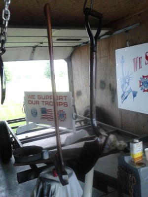

First coat of stain.
03 IMGA0155.jpg (21.6 KiB) Viewed 13954 times
More stain & starting to dry.
04 IMGA0156.jpg (23.67 KiB) Viewed 13954 times

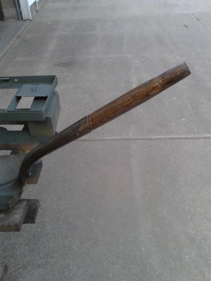

Handle assembled and final coat of stain. Then comes the steel wool!
05 IMGA0157.jpg (29.68 KiB) Viewed 13954 times

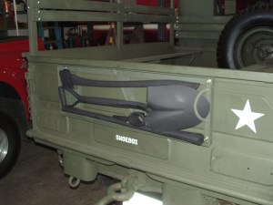

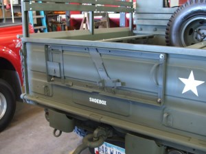

Here you go Tim, I think it was the 8th post and the picture is of Carters pioneer rack and strap configuration.
http://www.g741.org/PHPBB/viewtopic.php ... aps#p56485
Re: Pioneer Tool Shovel Modification
The tool rack has 3 loupes for straps in these locations, these are the correct spots for hold down straps. I was using a 4th but have now remove that one and this shot I have incorrect straps, WWII ones because I like the look but the locations are correct.

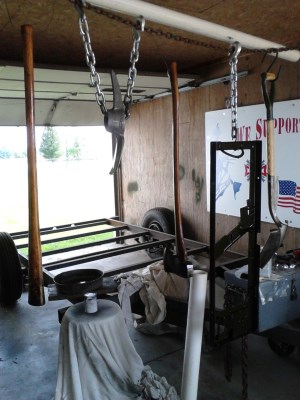

Trucker-Tim Not Happy.
Tools don't seem to fit right?
Straps don't seem to be long enough?
Is the ax sitting far enough into the slot?
I'll get some better shots tomorrow outside in the sunlight.
