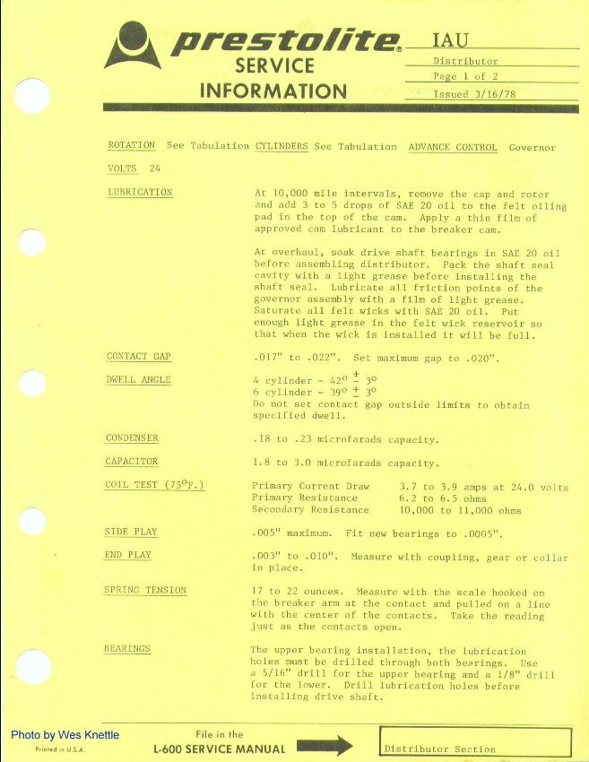

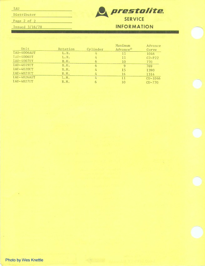

If you at least review the overhaul manual (TM 9-1825B) for the Group 3 waterproof Auto-Lite distributors the above specifications and methods are all listed there. I have PDF copies of this manual section loaded on my web sites for members to use. The civvy Prestolite service manual specifies fitting new bushing/bearings to 0.0005" which of course equals the bore diameter posted above of 0.001 over 0.500 if you have a 0.500 shaft. I would not discard my shaft unless I could not maintain the actual required clearance. IE if your shaft is straight and 0.498 and the bushing can be reamed to 0.499 then you do not have a problem with the shaft.
http://www.willysmjeeps.com/v2/modules. ... tit&lid=15
IAU Pg 1.JPG (116.08 KiB) Viewed 1444 times
IAU Pg 2.JPG (54.32 KiB) Viewed 1444 times
If this web site manager would like to make these available to this web sites members he can contact me anytime.

cuz wrote:If you at least review the overhaul manual (TM 9-1825B) for the Group 3 waterproof Auto-Lite distributors the above specifications and methods are all listed there. I have PDF copies of this manual section loaded on my web sites for members to use. The civvy Prestolite service manual specifies fitting new bushing/bearings to 0.0005" which of course equals the bore diameter posted above of 0.001 over 0.500 if you have a 0.500 shaft. I would not discard my shaft unless I could not maintain the actual required clearance. IE if your shaft is straight and 0.498 and the bushing can be reamed to 0.499 then you do not have a problem with the shaft.
Actually you do have a problem with the shaft in the above mentioned situation. That problem would be that the shaft does not wear on areas that are not in the bushings, thus these areas on the shaft that are not worn will still be .500" diameter. The unworn shaft area must go through the bushings in order to install it. Last time I checked, you couldn't put a .500" shaft through a .499" bore. You must have at least a .501" bore in order to insert the shaft, regardless of whether it is new or used, the areas that don't wear simply will not go through a bore if it's under .501".
